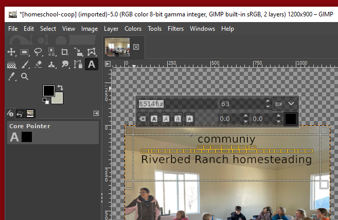

My challenge is that since GIMP updated, the options shown in your image don't show for me.
File comment: Very few text options.
Is there a way to turn them (back) on?

It looks like you need to add the "Tool Options" tab. Click the eye icon in step one, choose "add tab" then "tool options."
