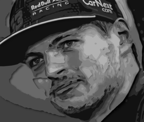

Thank you.. I had already come this far.
This is the result after I separated the layers and shadowed them 3d .

Adding texture to the paper would go a long ways. :)
