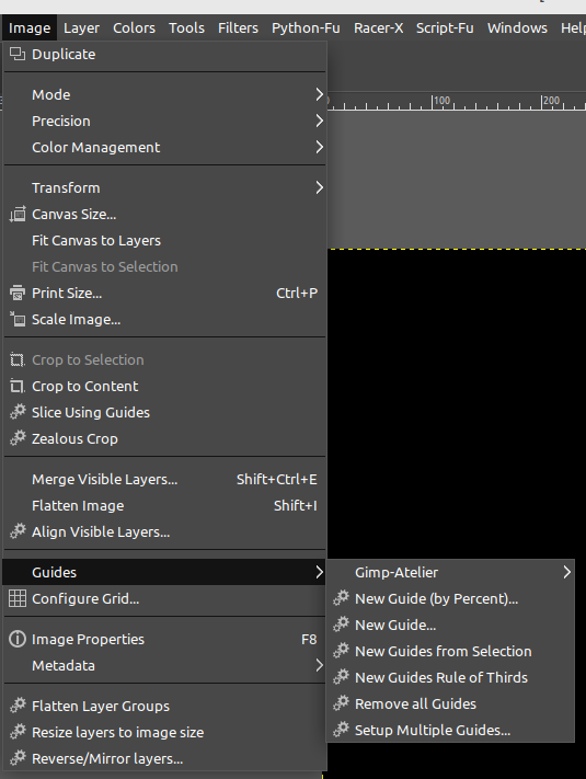

I don't believe I ever had "add guides" in my Image Menu, this is what I have.
Under where it says guides. "Add a new guide" I don't even have that anymore

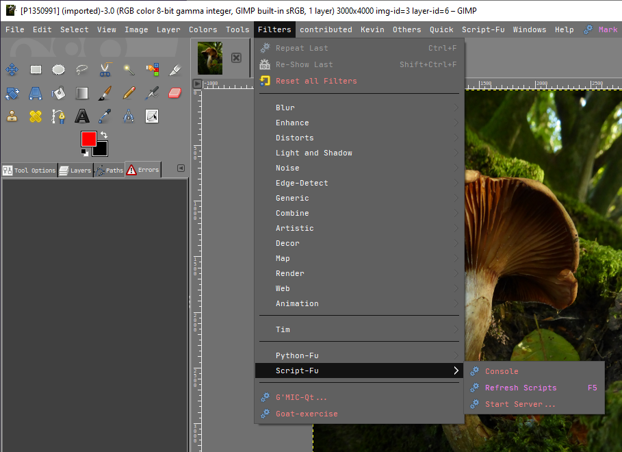

This problem got reported by someone else: https://gitlab.gnome.org/GNOME/gimp/-/issues/5615
Let's first try checking if any of your script-fu is working...
Do you have a Filters>>Script-Fu menu entry?:

You will need to do some investigation ;)
Image -> Slice using Guides (was Image -> Transform -> Guillotine in Gimp 2.8) is a plugin (guillotine.exe)
The standard entries in Image -> Guides are all script-fu If none register then no menu entry.
You need to check is script-fu is working ? Is there a Filters -> Script-Fu entry ? Is the Filters -> Script-Fu -> Refresh Scripts there and does it do anything.
A long-shot, do you have/had the script-fu scrolling replacement installed ? Is it still there ?

I suspect (what Paynekj wrote about):
base script-fu omitted (bug in Preferences - probably taken from older version?).
Please do not mention the scrollbar version of script-fu as the possible cause of the error (I can probably always prove on Windows that the reason is different - with one exception: the wrong version is installed). :mrgreen:

Hm that's strange , yes scripts has gone. I don't usually shut gimp down. So I'll try to shut it down and open it again and see what happens

What I should have done before I mentioned it. :oops:
It's all there now :)
