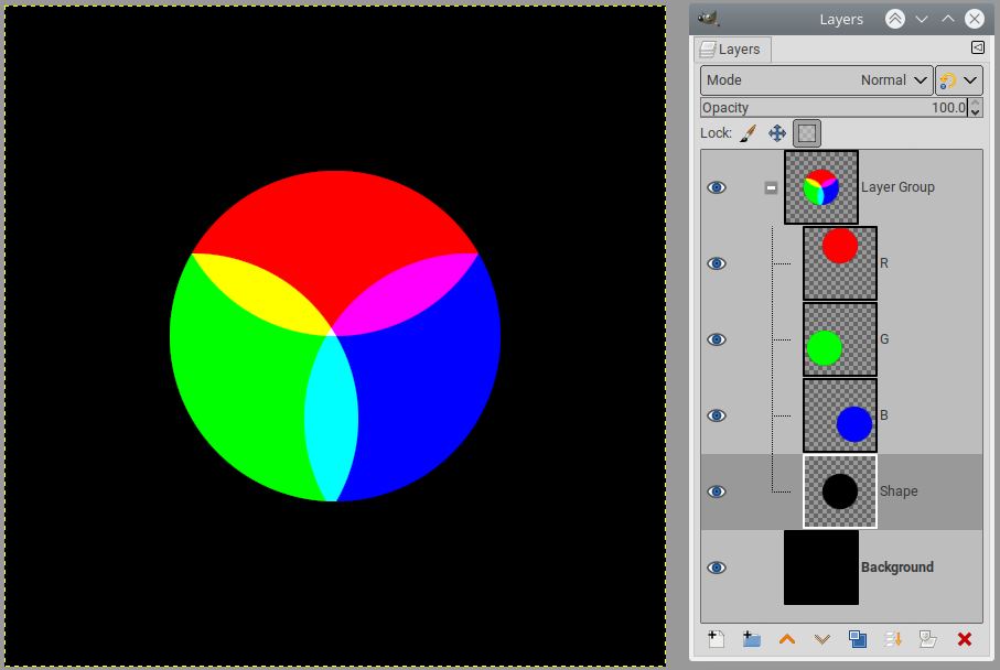

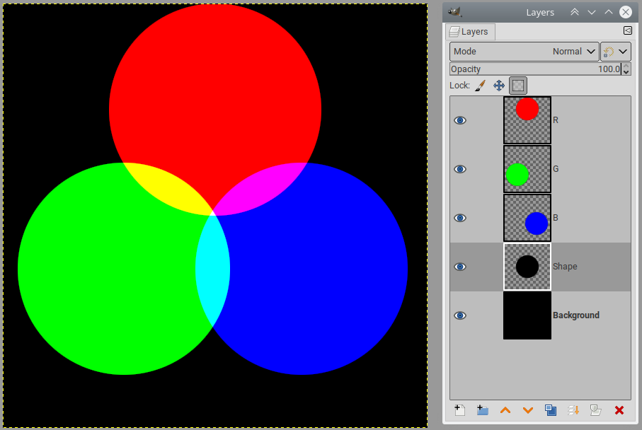

Groups act as parentheses in formulas. A layer applies to what is below at the same nesting level. So in a group, the layers of the group are composited between themselves and the group represents this (virutal) result, to which the group's blend mode (and mask) is applied, before being composited in the group above....
For instance, in this image, the color circles in addition mode apply to the whole background and the shape is ignored.
By putting them in a group with the shape, the action is restricted to the shape: the Addition mode keeps the opacity of the pixels it is composited to, without a group this is the whole background, with the group this is only the non-transparent pixels in the shape.
