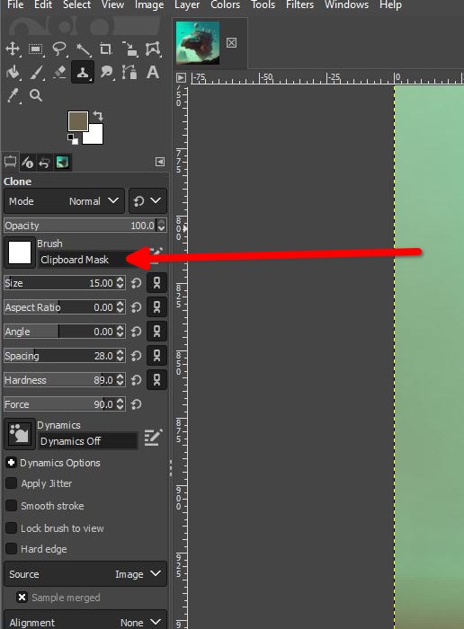

When trying to remove a watermark with clone/healing nothing happens, I also then noticed i can't paint or use eraser or smudge tools directly under 'file' on the left hand side. I found an online "how to guide" but it doesn't work.

...Except this still doesn't work and nothing happens!!! I can't clone, I can't heal even though I ctrl click to set a point before hand. It won't work in the image layer or new layer i create. I can't even just paint random lines across the image (like you can easily do in paint when clicking on the paint brush tool). Here in GIMP "nothing happens" seems to be the default setting!!! HELP!
edit: hmmm i think finally after writing this help post then going back and adding the image, then reviewing the image i submitted i noticed this mask thing... it was using as a sample. under brush it said clipboard mask. i changed it to a big black circle brush and now its painting. doh. This program is so hard to use until you figure out how to use it. not intuitive at all. Okay well now i think the cloning tool is working now that i've answered my own question. :D Well i guess this forum did help- sorta :D :D :D

Your brush is set to clipboard (which probably is empty).
Set it to something else.

It's because you have selected the "Clipboard mask" which is empty at the time you are using it, just select another "proper" brush by clicking on that white square and your healing tool will work "again" as you intented

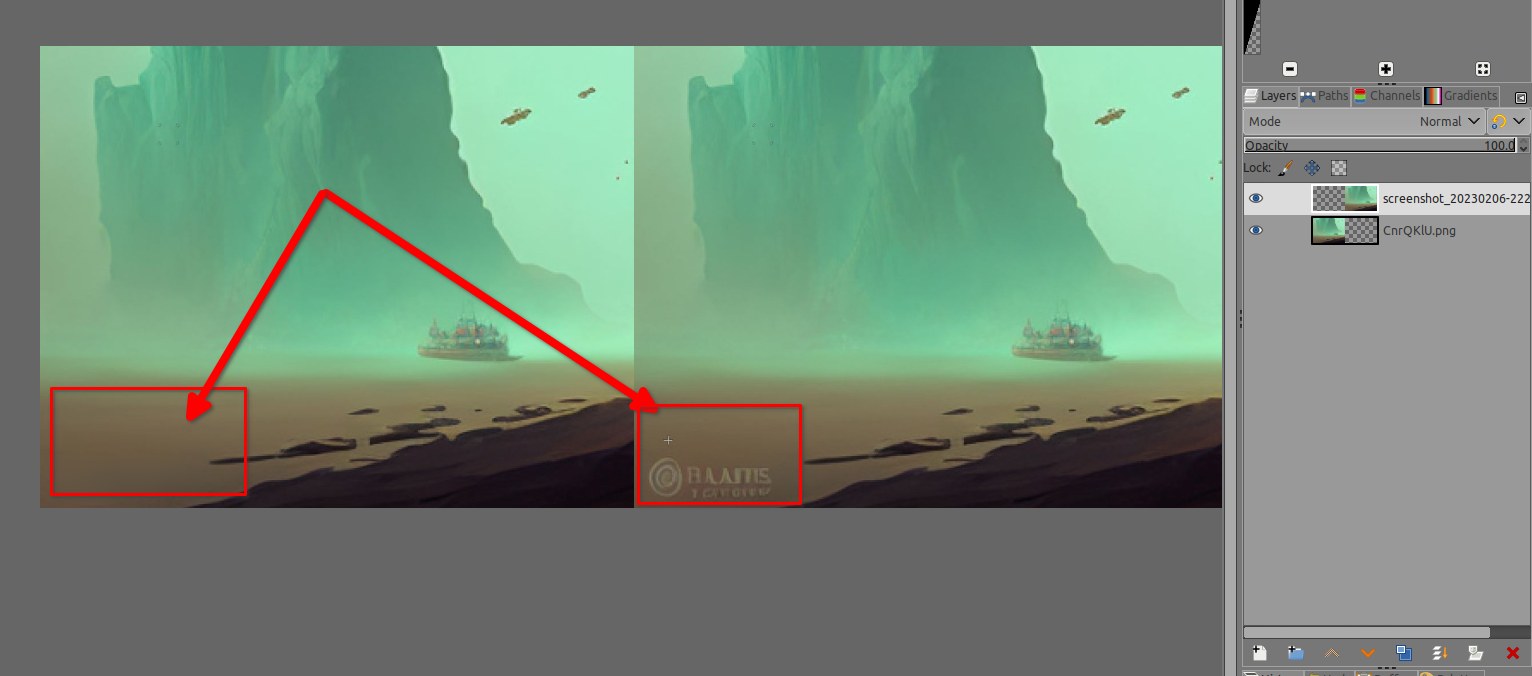

Anyway that's not how I would do it, too much waste of time, cumbersome and the result will be arguable as the BG is a gradient.
I would select the watermark with the free select tool, no need to be precise, just roughly circle it.
then go to Filters > Enhance > Heal selection... a window opens, just click OK as default setting are fine.
Done!
