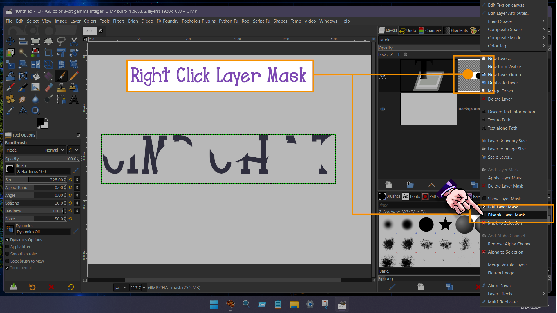

There is a right click menu function of the layers panel/dock,
that will allow you to disable the layer mask.
Right click the layer mask and select Disable layer Mask.
Note: The layer mask can be enabled again later by unchecking it.
