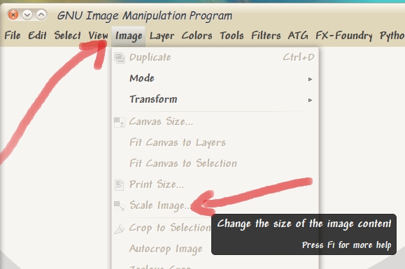

:crop Crop the image if needed then scale it
this brings up a window where you choose exact pixel size
