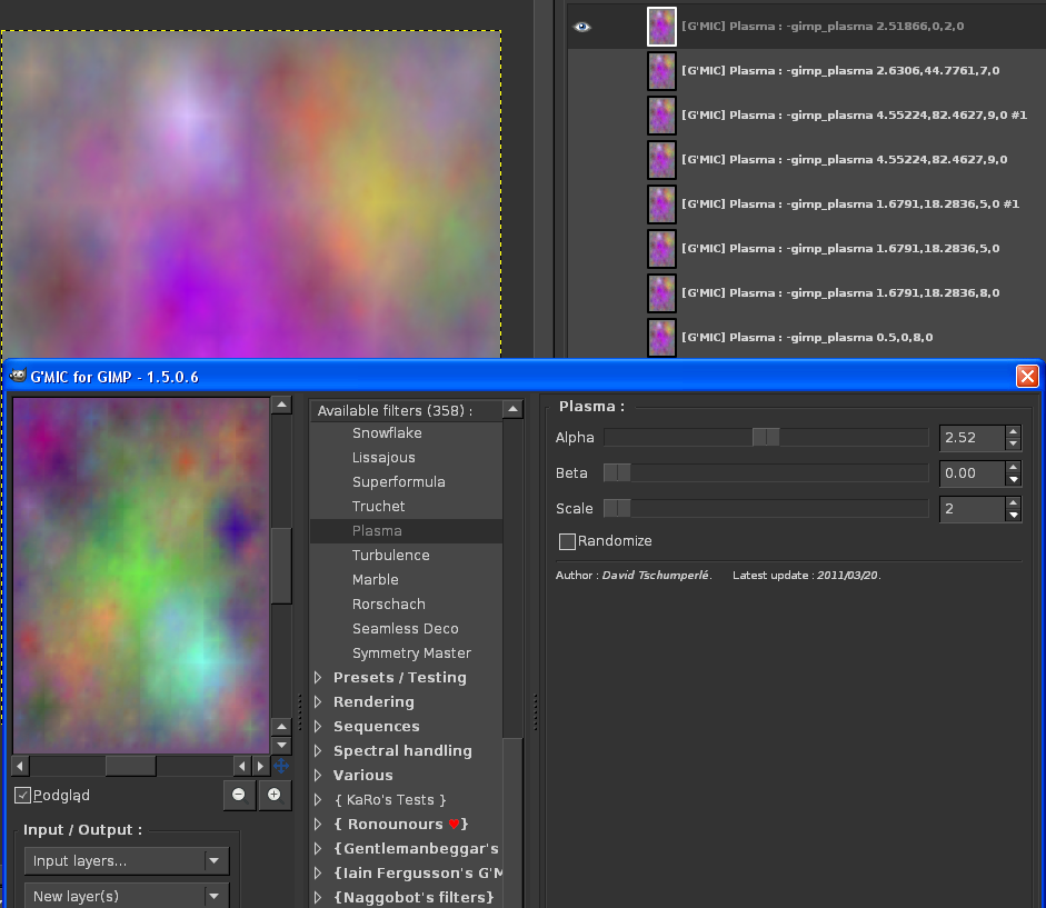

For 1.5.0.6 - does not work
Another view of the outcome (different parameters - same result)
For 1.5.0.7 (beta) otherwise - working properly.
[XP 32 bit, Gimp 2.7.4]

G'MIC 1.5.0.6
Windows 7 64-bit
Gimp 2.7.4
The layer does not match the preview.

PhotoComix wrote:
@ partha
and layers are different or identical ?
Virtually identical. I did apply 3-4 times creating a new layer each time. I think there was a slight difference between a couple of the layers.

Having a random behavior is the desired behavior.
PhotoComiX has pointed out that previous version of G'MIC (1.5.0.6) was not really random on Windows. If this is random now, then this is great :)
