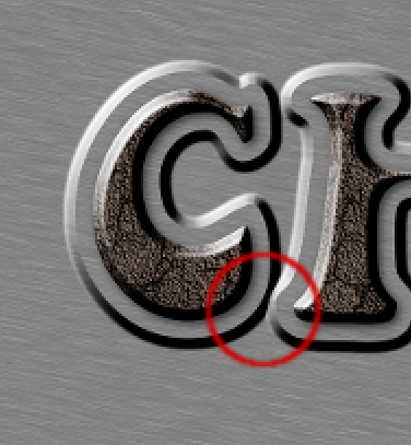

started with this txt and ended up making a pattern from it..(scaled down for GC)

very nice text effect, alc !
i wouldnt make a 2000x2000 pic into a pattern, takes up way too much space
and Gimp has to load it with each start !
why not use it as a texture and open as layer ?
EDIT:
may i point out that you have a slight space-time-continuum-problem in your picture ?

"slight space-time-continuum-problem in your picture" :gaah didn't even notice that, Eagle eye :hehe
