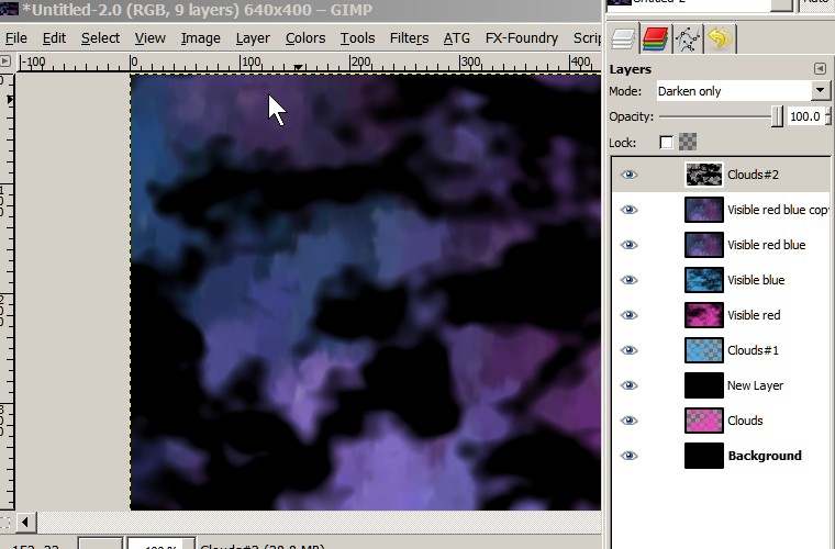

Hearty , That is an excellent image. I have been working on something too but it hasn't got a patch on your image. I have been working with render fog on black backgrounds, making new visibles in two colours, combining the two, new visible, cubism and blurring before using Artistic Gimpressionist. I will keep trying a while longer with different brushstrokes in Gimpressionist. Still No Cigar though! Well done!
