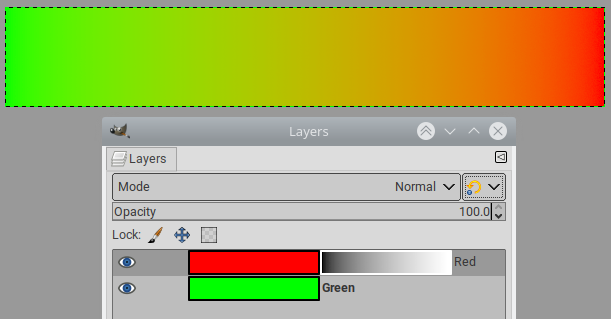

Your "smoking gun" is a different problem. You tried to do an arithmetic addition and Gimp isn't about linear arithmetic but about visual results that require logarithmic corrections (aka "perceptual")(for instance the "perceptual" 50% gray (the tone of a checkerboard seen from far away) is (185,185,185) and not (127,127;127) .
In Gimp 2.8 and previous all computations were done directly on perceptual, which produces false results, a well know example being a red-green gradient, which if done directly with perceptual values goes through brown, while it should go through orange. Since Gimp 2.10, if values are kept as "perceptual" values (at least in 8-bit/channel images) the computations are done on linear data (so there is conversion before and after). This applies also to blend modes. Try this:
- Create green layer
- Add a red layer
- On the red layer, add black white layer mask (make sure the "blend color space" is "linear RGB" in the blend tool). If the Red layer is in Default/Normal, you get a nice red -> orange -> green gradient:
- If you set the red layer to Legacy/Normal your get a red -> dirty brown -> green gradient:
In 2.10, unless you have a very good reason not to (and if you find one it will usually not be, it will just be that you are trying to solve the wrong problem), you should use the default "linear" modes.
