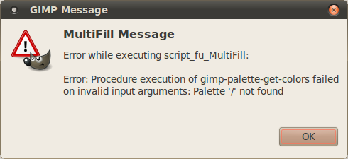

I applied all your recommendations, and got it to register, but I see a conflict between the ability to select your directory and declaring a directory name (at least I think it's a conflict).
I also get this error when attempting to use patterns:
EDIT: Fixed this by putting the palette back in. Heh!

I don't know if it can access a list, either. But saulgoode did offer to help with randomization of patterns.
Right now the script is telling me: Error: eval: unbound variable: inPatternDirectory with all his recommendations implemented. Menu pops ok, everything looks good til you try to run any option, doesn't matter which option you choose, same error.

The coder? Hahaha... I already admitted I was in over my head, I'm just remaining determined. :)
And no, I didn't take offense to your earlier comment. I was trying to sort out any possible confusion before it even exists. I have Project Manager mentality. :gah!
Saulgoode used string-append:
(patterns (cadr (file-glob (string-append inPatternDirectory DIR-SEPARATOR "*.pat"))))
I got to thinking maybe it needs to be defined. When I add it to define, it then declares the new error:
Error while executing script_fu_MultiFill:
Error: string-append: argument 1 must be: string (so I think by adding it to the define list, broke the string). I have no idea how to define, so I am searching for similar scripts.
The 'inPatternDirectory' variable needs to be added as a parameter to the main 'script_fu_MultiFill' definition such that it is associated with the corresponding widget (SF-DIRNAME) created in the registration procedure.
 Post subject: Re: Multi-Fill Script Help
PostPosted: Sun Feb 27, 2011 10:53 pm  (#20)
When I do that, it gives the string error I mentioned above.
