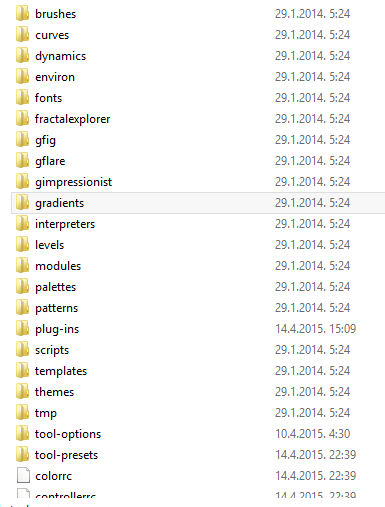

PostPosted: Tue Apr 14, 2015 3:58 pm  (#19)
Joined: Apr 14, 2015
Posts: 29
yes thats what i mean
i see gimp folder 2.8 i clicked in there
folders are there
but they are empty
here are the pics
File comment: folders
