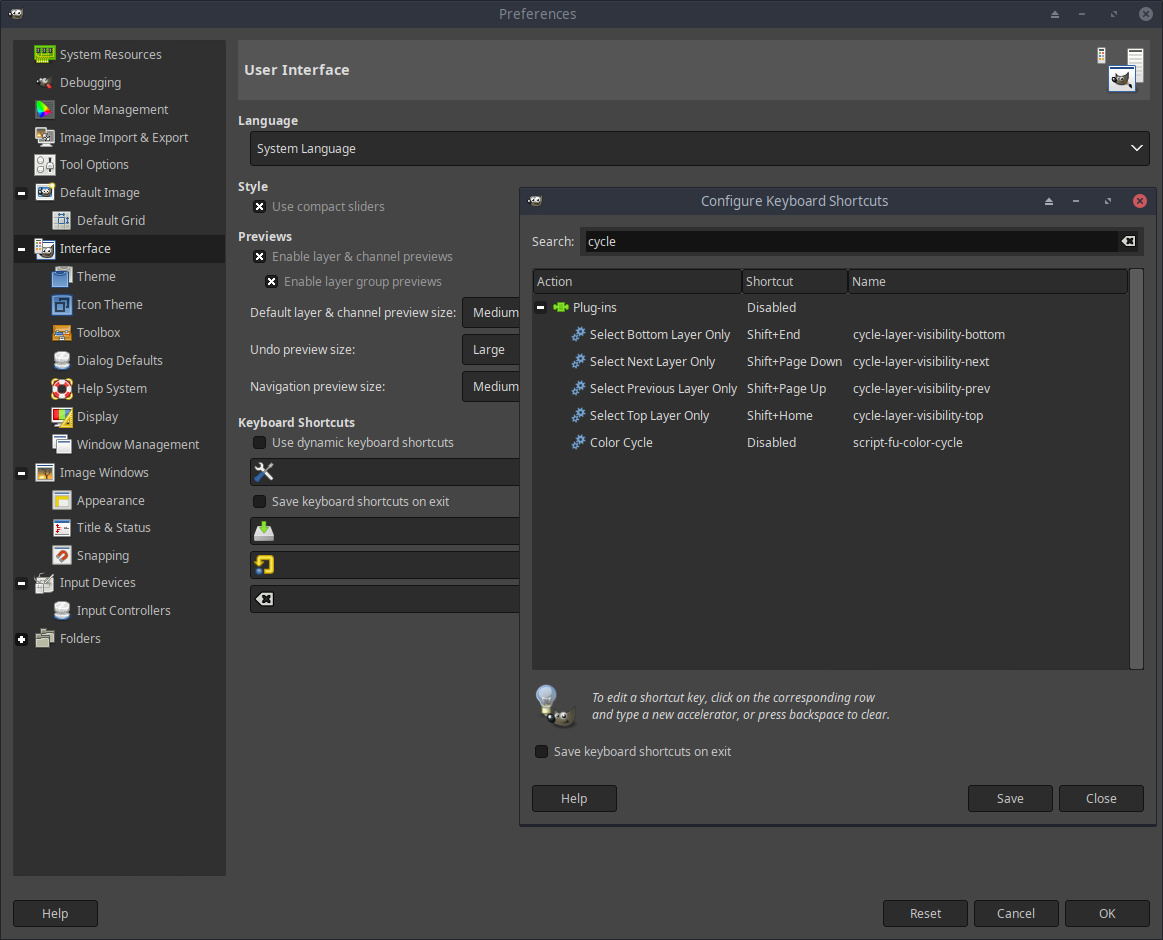

Yes, for this I use a script called "cycle-layer-visibility.scm" (attached)
Create shortcuts for it first, Edit/Preferences/Interface/configure keyboard shortcuts.
Then you can switch easily to previous and next layers, and top or bottom layer using your shortcuts.
If you keep the previous or next keyboard shortcut pressed down, the effect is similar to filters/animation/playback on the canvas.
I think it was originally written for short animation preview and sprite work etc.
cycle-layer-visibility_0.scm [2.9 KiB]
Downloaded 157 times

The script I attached, if you asked about it is .scm script and goes in the scripts folder, inside your Gimp user folder. No installing involved.

I downloaded that attached file outside of all these folders but Gimp doesn't display a choice for Add a New layer.

I visited Edit> Preferences >Interface and I see Keyboard shortcut which are all disabled.
Which ones must I enable to make your attachment work so I can make the background black?

Gimp user folder isn't in C:/Program Files, it's in the user folder.
Make sure "show hidden folders" is on, or you won't find it.
Browse to C:/Users/*yourname*AppData/Roaming/GIMP/2.10/. This is your user folder,
where you add all the custom resources, palettes, gradients, etc.
