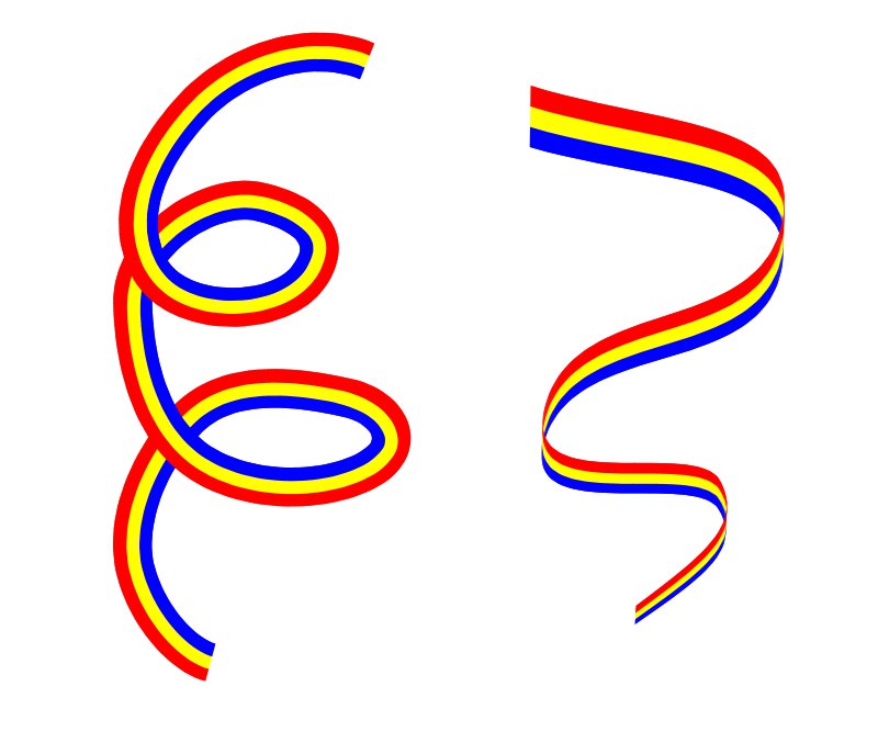

As mentioned my path blend script viewtopic.php?f=9&t=4066 can be used to draw ribbons:
The one on the right was done simply by creating a path and then duplicating, scaling and moving it down a bit, then running the script.
The one on the left took more work, as I had to use Inkscape to get the two offset paths, using Inkscape's live path effects (pattern along path), converting that to a regular path and saving as svg, then importing the svg into Gimp.
-Rob A>

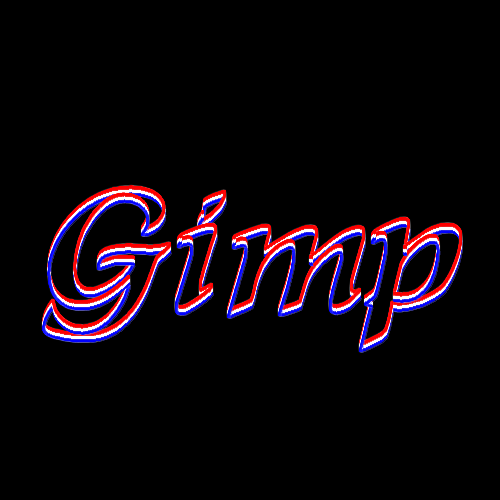

I decided to play around with O's brush idea. :)
The brush is red, white and blue so i made the bg black.

Nice Rod.
But if you see the result, there are those imperfections which I commented before. The band edges (especially the central band) are imperfect, pixelized or with steps. Obviously, working with a rectangular brush can cause these problems, but the imperfections are noticed very much.
I wish that Gimp could do a fine and better job about it.
