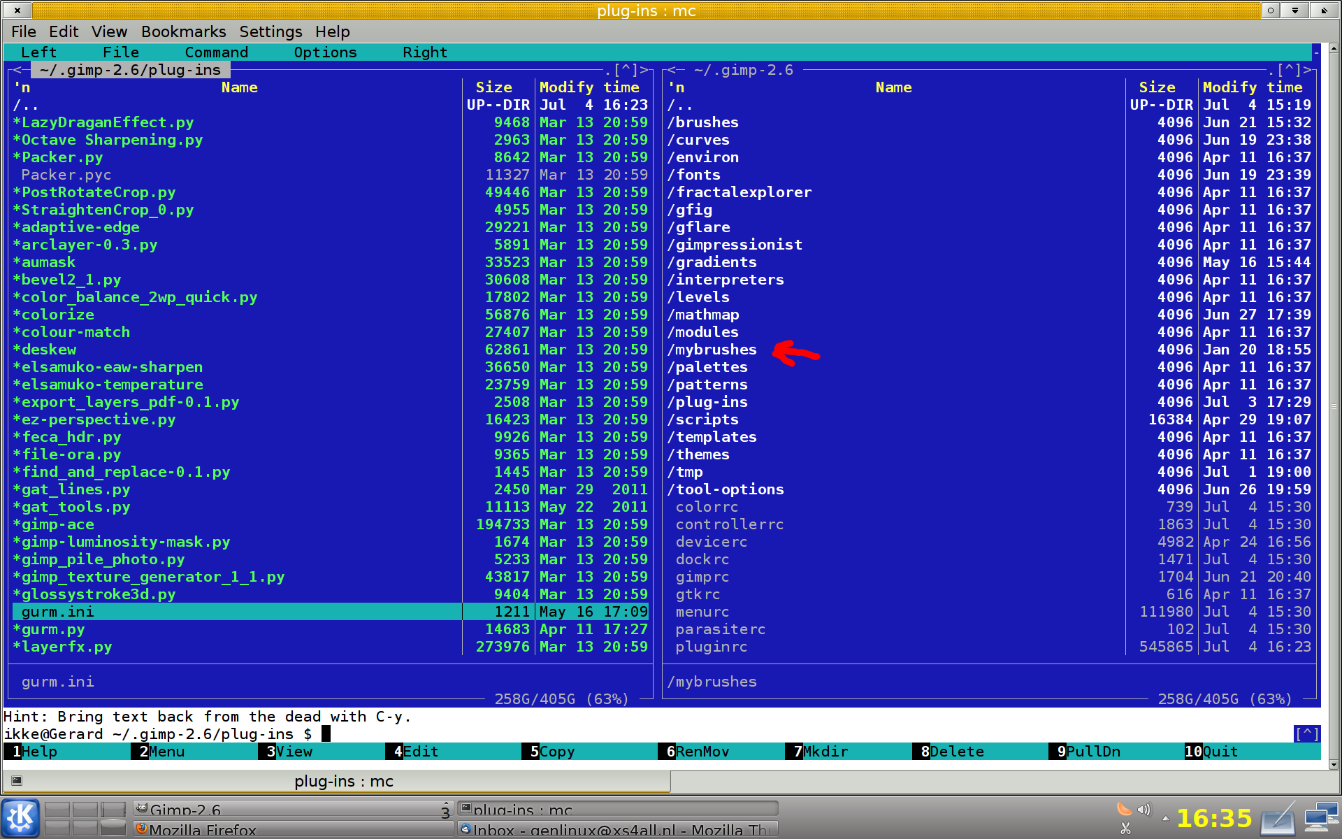

@molly,
For a non-techie it's probably easiest done by using "mc" aka Midnight Commander.
It should be available in Fedora since all linuxes have it.
You can of course edit files in a text editor but you'll have to make gurm.py "executable".
I added some screenshots to show how GURM is configured in my install.
Unfortunately I am only allowed to add three.
Once you have installed mc open it in a console by typing mc.
I'll continue when you tell me you've installed mc and post the rest plus the 4th screenshot.
Gerard.
Gimp-2.8.14
I use Linux only.
And Virtualbox with Win 7

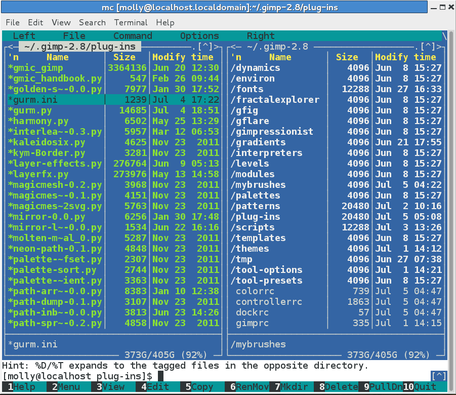

Thank you gerard,
I installed mc and I downloaded Gurm. I also placed gurm.py into my user/molly/.gimp/plug-ins. I made a folder in .gimp and called it gurm-ini and that is where I placed the .ici file
I used your two top screen shots and changed where you had the red marks.Image

OK.Browsing with mc will show you what's under the hood.
With mc running hit F9 and with the left or right cursor key make "Options" highlighted.
With the down cursor key set it on "Configuration" and hit Enter.
Again with cursor keys move to Safe delete and use space to tick it.Do this first to prevent accidental deletes!
Switching the cursor between columns is done with the TAB key.
Gurm1.png:column on the left is where the d/led gurm file was unzipped.
Column on the right is a directory in which I copied all my d/led brushes in separate directories.
I added this directory in the /home/ikke/.gimp-2.6 directory by positioning the cursor somewhere inside and hitting F7.
You'll get a popup window where you can enter the directory name,here "mybrushes".
When the mc cursor is over a zipped file and you hit Enter mc will unzip it.
The result is what you see in the left column.
(If it doesn't work quit mc install "unzip" and restart mc).
I copied the gurm.py file to the .gimp-2.6/plug-ins file by having the cursor over it and .gimp-2.6/plug-ins opened on the right
column then I hit F5 and enter to copy it.
As you can see on the screenshot gurm.py has no star which means Linux doesn't consider it executable.
To achieve that set the cursor over gurm.py in the plug-ins directory and hit F9.
You'll see one of the items on the menubar on top light up,using the right or left cursor keys move it over "File".
Open the dropdown menu with the down cursor key and position it over "Chmod" and hit Enter.
A popup window will appear and using the space bar and cursor keys you can make it executable.
When you see a star like with the other plug-ins then it's become executable.
Gurm.ini also needs to be copied to the plug-ins directory.
If it shows a star then same procedure as for gurm.py but this time remove the executable ticks with space key.
(Scripts don't have stars because they are "interpreted" tiny scheme files)
Gurm2.png: gurm.py needs to know where it can find the gurm.ini file.
You can edit by having the cursor over it and then hit F4.
What you see is mine but I think you can remove the Windows path and replace it with your path.
Don't forget the dot before gimp-2.x.
Gurm3.png:This is the gurm.ini file.
I only use it for brushes but you could use it for more if you want it.
useManager enables it when set to yes.
Note the spaces in front and after the "=" sign!
gimpPath is where gurm copies brushes from your brush collection so they become available when you work with Gimp.
usePath is where you have your collection saved.(mybrushes in my setup)
extensions is self explanatory.
installedOptions should be left blank for now.
Gurm4.png: shows you how it's setup on my system.
Almost got a heart attack when I tried to add the last screenshot.
Gimpchat suddenly asked me to log in and when I did it showed an empty reply sheet.
By going back a couple of times I got here again.
I hope this will get you going.
I'm going to bed now it's 00:30 am here.
Good luck and if anything is unclear I'll be back tomorrow.
Gerard.

Just noticed your reply.
It has errors in it.
home/molly etc. should be /home/molly and the double quotes on both sides.
Gerard.

PostPosted: Wed Jul 04, 2012 5:39 pm  (#13)
thanks gerard, I corrected that error with the quotations.
I got as far as delete in safe mode and I found how to get to the gurm.ini file but I don't know what to do next. I probably need a one step at a time instruction. Does this look right so far.

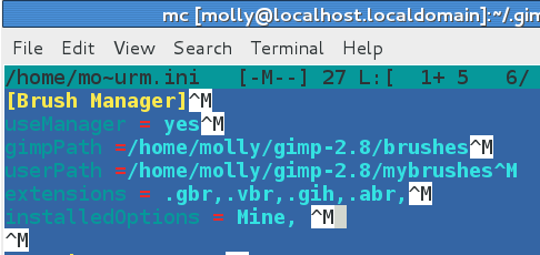

PostPosted: Thu Jul 05, 2012 6:46 am  (#16)
I think I am making a mess.
This is what I did when I tried to edit the Brush Manager.

Let me explain how Gimp administers brushes,scripts and plug-ins.
Gimp comes with a "standard" set of brushes which are installed in /usr/share/gimp/2.0/brushes.
Scripts that come with Gimp are in /usr/share/gimp/2.0/scripts.
Default plug-ins are located in /usr/lib/gimp/2.0/plug-ins.
This set will always be loaded when Gimp is started.
Gimp allows you to use your own brushes,scripts and plug-ins.
To keep things neat these are usually installed in your /home/username/,gimp-2.x/ directory.
Paths: a path directive tells a program where to find something.
This may be another program or other things to make it work correctly.
Paths are part and parcel of any Operating System,be it Linux,Windows,Mac you name it.
Remember computers are very stupid: You have to tell them exactly what to do,a typo will make it fail.
Now to get back to your last post:
gimpPath what you have there would be correct for Windows,Linux won't understand it.
It should read:
/home/molly/gimp-2.8/brushes
This is the default brush directory and gurm needs it to place the selected brushes.
userPath should point to where your brush collection is located.
/home/molly/gimp-2.8/mybrushes

As you can see on one of my screenshots I have quite a few directories with brushes in /mybrushes.
These will show up in gurm when you run it,you can then tick what you need.
This way you'll avoid having an enormous amount of brushes in Gimp.

ok, I changed it to this>

Please remove Mine from installedOptions.
Gurm will throw an error if you start it with something that it hasn't loaded into ~/brushes.
For the rest it looks ok.
Have you created the mybrushes directory and filled it with directories containing brushes?
Gerard.
Edit:Taking another look I saw that you don't have spaces after = in gimpPath and userPath!

No, I haven't as yet Gerard. I removed mine beside installed options. Beside user path, that little white square was missing when I was editing and I can't get it back. I got the ^M there but I can't get the white box that flash's. I don't even know what those are.
I didn't mess with the my brushes directory yet until I made sure the rest of it was okay so far. I have so many brushes and I would like to find a way to identify and group them first.
