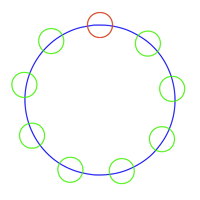

Look at Filters/Render/Gfig for the basic geometric shapes. But I don't like it because geometric shapes are better done using and transforming paths and Gfig doesn't create paths. So my favorite tool is the shape-path script.
For many things you'll have to learn to use the Rotate tools in Path mode. If you are smart you can minimize your work: for instance, instead of taking one circle and rotating it 9 times, you rotate it once, merge the two paths, and then rotate it 4 times.
To measure things there is the (tadaa!) Measure tool.
Then you can also be lucky... for instance to create these 10 circles, I used my path-inbetweenerscript, telling it to go from the the small circle path (in red) to the small circle path again, telling it to generate 10 steps (in green), following a guide path (in blue).
