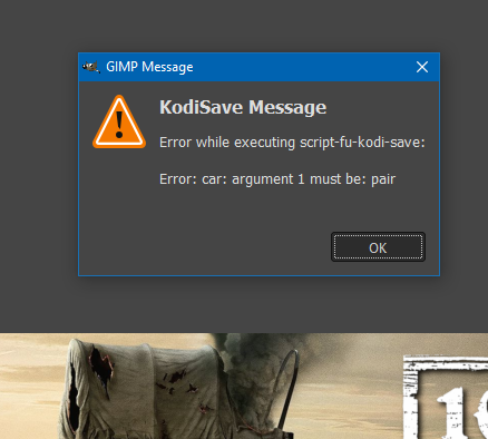

I'm getting this error:
> (KodiSkinPath (gimp-image-get-id) (ReadKodiSaveArtType))
Error: eval: unbound variable: read-line
Using Windows 10.

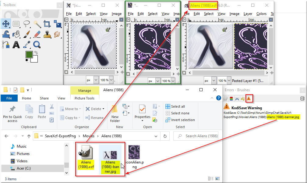

I found that the Gimp status bar is very volatile. :shock:
The KodiSave message is often overwritten by any other messages if the user moves the mouse pointer.
So, in 1.1, the KodiSave message is also displayed in the Error console even if it is not an error.
To open the Gimp Error console, click Gimp menu "Windows" > "Dockable Dialogs" > "Error Console".
KodiSave will display its message of export in a persistent way until you clear the Error Console. :hi5

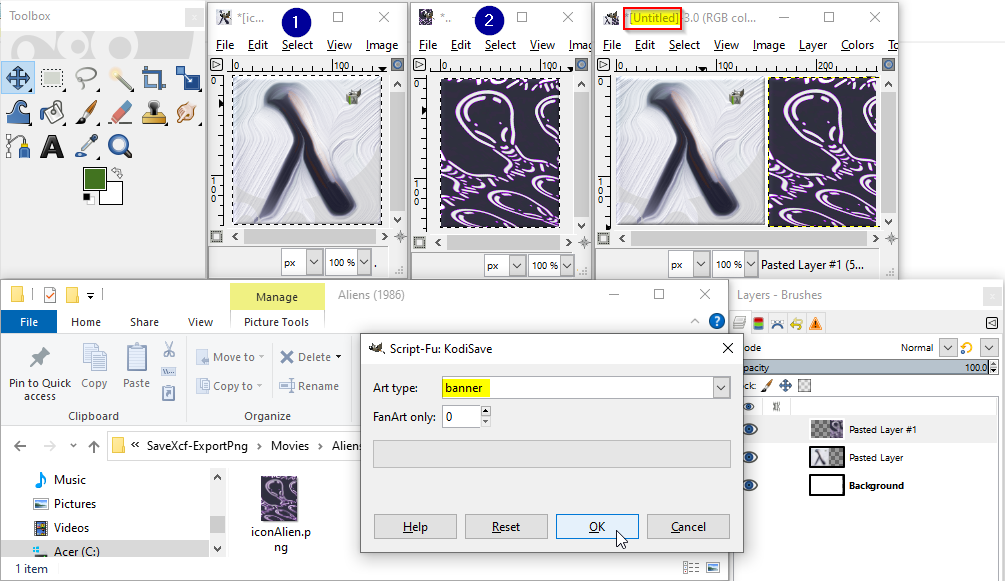

KodiSave 1.5 with dialog box for art type = clearart
KodiSave 1.5 with dialog box strongly simplifies the Scheme code since the text file KodiSaveArtType.txt is no longer required.
Hence the I/O library for Script-Fu has been removed.
However you would select the art type in the dlgbox if you wish to change it.

  1. In File Explorer, navigate in Movies\Aliens (1986)
    Drag & drop for example iconAlien.png in the Gimp empty editor.
    This icon has been generated by AI-based Bing Image Creator from a textual description then modified :paint in Gimp. :gimp
  2. Click menu KodiSave
  3. The Script-Fu:KodiSave dlgbox pop-ups. Click the listbox down arrow.
  4. Select your art type such as "clearart"
  5. Click OK

Once you confirmed the saving of .xcf and the export to .png:
  1. A message is displayed in the Error Console as a Warning. :scram
    It is the only way that I know to display a persistent message.
  2. The Movies\Aliens (1986) folder is populated with the .xcf and .png :party
    Note that the basename includes the name of the movie.

Also forgot to mention, it seems to be warning me every time it exports even though it works as expected. I did a normal export and it didn't flag any warnings.
Have no idea what would cause that, but noticed the behavior.
File comment: Warnings: Not sure why, but still works correctly...odd
 Post subject: KodiSave 1.4 FanArt# as integer
PostPosted: Sun Apr 23, 2023 9:45 am  (#20)
Joined: Oct 23, 2021
Posts: 67
See above the updated source code 1.4. :mrgreen:
This behavior is by design. Since, the KodiSave message in the status bar could disappear,
we use the Error window to persist the message as a warning even if it is not a warning or an error.
If you do not wish any message in the Error window, put in comment adding ";" in the beginning of the line 154:
(gimp-message (string-append "KodiSave: " fullSkin))
Alternatively, if you do not wish to put in comment gimp-message, you can delete this line.

I was trying 1.4 out but not for fanart (other things to complete), I went to export as banner and ran into this output error:
File comment: Save as banner operation

 Post subject: Error: car: argument 1 must be: pair
PostPosted: Wed Apr 26, 2023 5:24 pm  (#23)
Posts: 67
I cannot reproduce the following issue with art type "Banner" index 2 in KodiSave 1.4
Try to indicate more context such as full path of picture, states of each element of the KodiSave dialog box.
Run the Script-Fu console by "Filters" > "Script-Fu" > "Console" (Alt+R S C).
The function car retrieves the first element of a given list such as '("root" "png")
(car '("root" "png"))
"root"
Let us remove manually the first element. The list becomes '("png")
(car '("png"))
"png"
Let us remove again the first element. The list becomes empty '()
(car '())
Error: car: argument 1 must be: pair :gaah
In other words, car does not like the empty list.
In KodiSave 1.4, I mainly introduced car in KodiSkinPath in the affection of the local variable strFanArt of type string.
(strFanArt   (car (strbreakup (number->string intFanArt 10) ".")))
You cannot directly run this affection.
But try to run the examples in comment starting with ";" above the define such as the last one:
Do not copy the ";" but after from the opening parenthesis until the corresponding closing parenthesis.
(KodiSkinPath "C:\\Movies\\Aliens (1986)" "Aliens (1986)" 7 5.1)
"C:\\Movies\\Aliens (1986)\\Aliens (1986)-fanart5.jpg"
It does not matter if the path exists or not.
The expected result is also supplied as a comment before the define.
Try to reproduce your own context about:
  • your path of picture. Do not forget to double backslash in Windows;
  • your art type banner has for index 2 instead of fanart at 7;
  • fanArtNbr should be 0 but indicate the real number of the spinner.

I got how to reproduce error, using method I described above.
It works with a single layer, 2 layers, 3 layers > crash (I assume it will also crash on 5, 7, 9, 11 or any other odd number of layers)
Ok, so I open image 1 (Tab1)
Open image 2 (Tab 2)
Create new image (Tab 3 Blank > Dimensions I am using 1000x185 > Should not matter)
Tab 1, select all, Copy, Paste as new layer into Tab 3
Tab 2, select all, Copy, Paste as new layer into Tab 3
Kodisave with Tab 3 Active > Click > must be: Pair error
I have to do the method this way because in order to create a "banner" for Kodi, I need a Main background image of the movie/tv show itself, I use the "clearlogo.png" of the movie/tv show, those two items are combined in Tab 3 using predefined template dimensions of 1000x185 pixel requirements set by Kodi and I use for all banner creation so I don't have to think about it and reduces setup and keystroke entries etc.
So it seems the script is trying to do something in pairs vs the active tab layer when it is active.
I "think" that is were the issue is, but I can't seem to follow the scheme code to try and adjust it. I will continue to look at it.
As a note, 1.2 didn't have this issue. 1.3 is missing in this thread as it was over written by 1.4. So I can't verify 1.3, I am looking to see if I saved a backup copy somewhere so I can test that to see where the issue come in.
Hopefully this helps give some insight??

kittmaster wrote:
images located in "C:\Users\chris\Desktop\Kodi\1883 (2023)", load image file 1, load image file 2, merge 1 and 2 into template (banner
So merge 1 and 2 should be in the same folder than the last loaded image 2.
kittmaster wrote:
Create new image
This the new operating mode.
In all previous screen captures in page 1-2, the first step was a drag-and-drop: so the target picture had always a title.
When you create a new picture, the image has not yet been saved and its title is: "Untitled":
KodiSave 1.5 introduces the new function SearchFilename starting from the target image having merge 1 and 2.
If the filename is empty, SearchFilename searchs in the vector of all loaded images then choose the last loaded image having a non empty filename.
In our case, it is picture 2 with a green frame.
The SearchFilename code begins to be complex with three levels of let* :shock: including a loop in the vector of image id.
 Post subject: How to debug the car issue?
PostPosted: Fri Apr 28, 2023 3:54 pm  (#29)
Posts: 67
(tracing 1)
enabled the very very long trace of all functions ended by (car '()) ; first element of the empty list generated the fatal error.
After the error, never forget to restore the disabled trace by:
(tracing 0)
The bug was in PathInfoPic: the fullname of an untitled image was the empty string. :oops:
Spliting the empty fullname removing each DIR-SEPARATOR generated ("").
Removing the filename from lstPath generated the empty list ().
Rebuilding the path without the filename caused the fatal error in unbreakupstr. :roll:
This function is provided in C:\Program Files\GIMP 2\share\gimp\2.0\scripts\script-fu-compat.init
And, until now, I did not know that unbreakupstr could include the call of car.
The fun of the story is that, in 1.5, I instrumented KodiSave replacing all calls of car by a debug version named carDbg.
carDbg does exactly what car does but if the list is empty, carDbg displays the running context: the caller and one of its parameter.
In fact, carDbg never fired the fatal error since it was in :shoot unbreakupstr :arrowshoot outside KodiSave.
