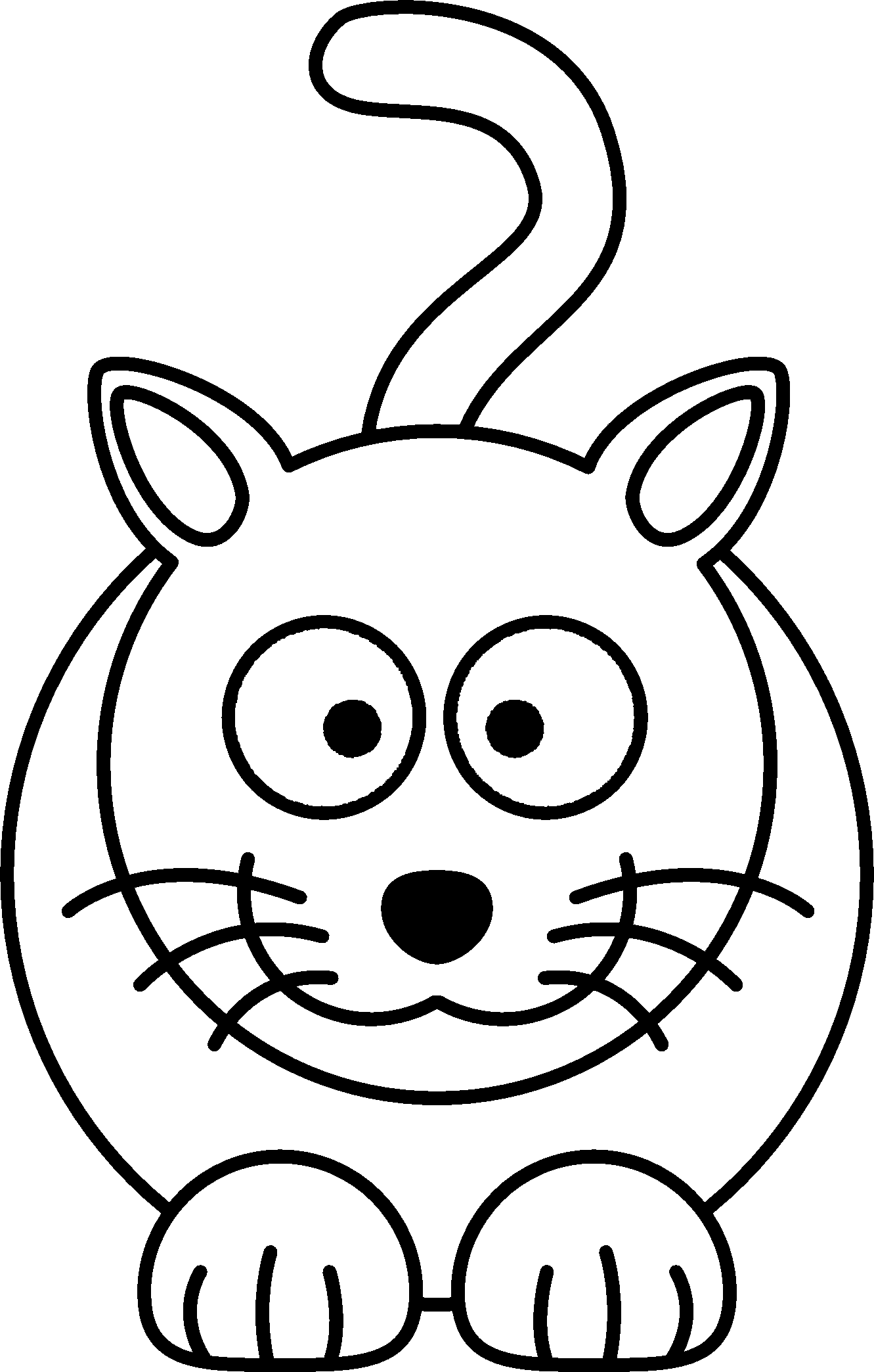

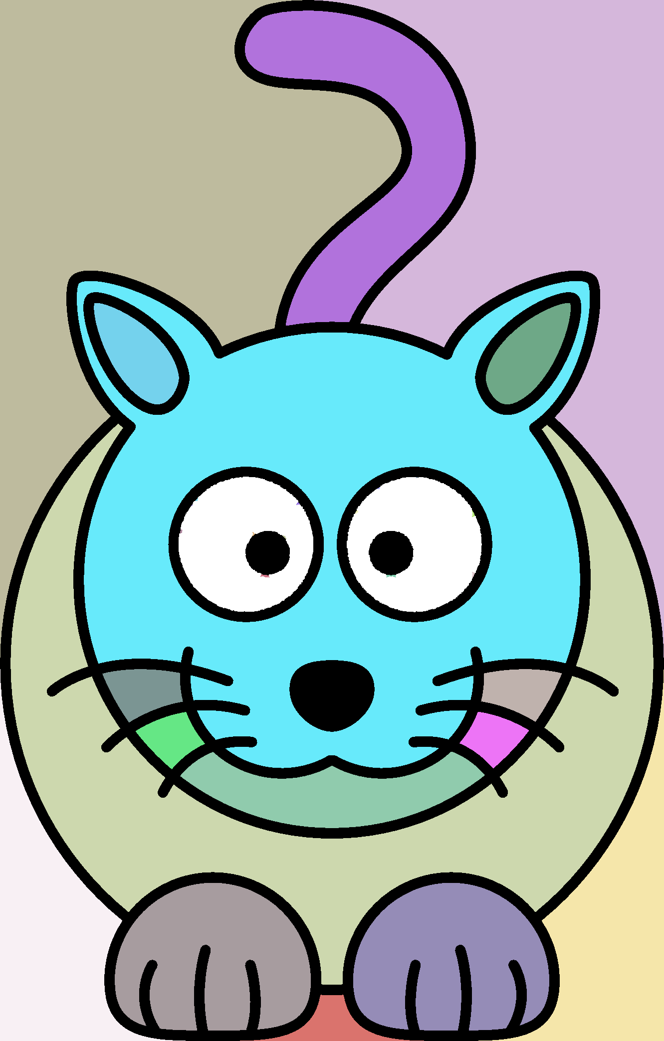

 Post subject: Re: Multi-Fill Script Help
PostPosted: Mon Oct 07, 2019 1:54 am  (#124)
Posts: 14263
I used your script, Dinasset. It's quick and very effective. Thank you so much.

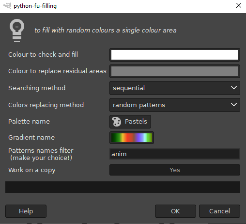

I have a lot of patterns series.
I attach one of mine (Animals).
7-Animals.7z [699.23 KiB]
Downloaded 119 times
All the names have the string "anim", so you may enter 'anim' when launching the filter
Here a resulting outcome
PostPosted: Tue Oct 08, 2019 10:51 am  (#138)
Actually, after having executed the chosen option for filling, the filter replaces the remaining white areas with the gray: replace the gray with white in the parameter panel.

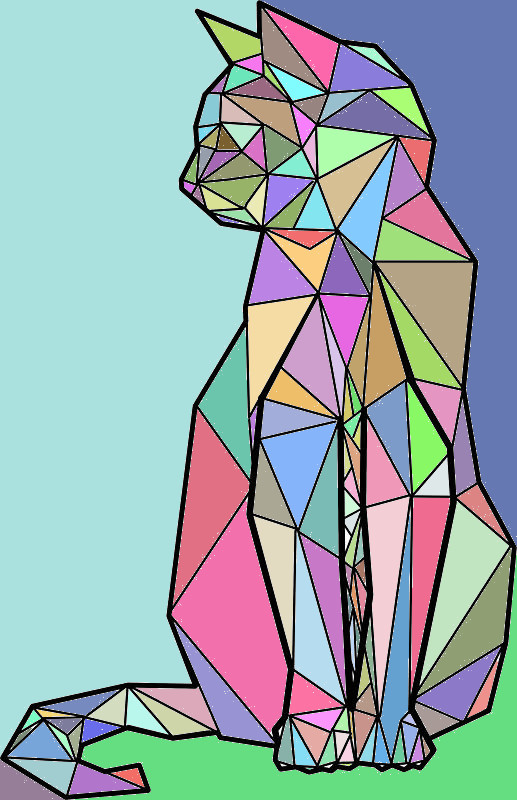

PostPosted: Tue Oct 08, 2019 11:05 am  (#139)
Posts: 14263
These are my results using gradients and patterns. Only a very few white zones left without filling.
Thank you Dinasset. A good work!
PostPosted: Tue Oct 08, 2019 11:14 am  (#140)
Joined: Sep 23, 2019
Posts: 31
thanks a lot for your help and your awesome plugin!
much appreciated
