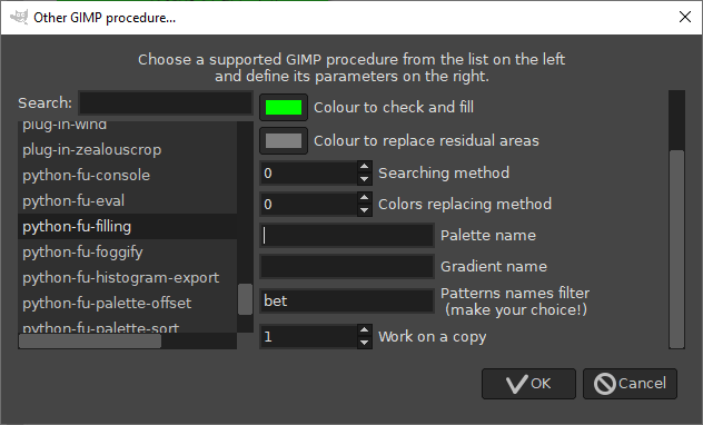

Diego, one question. I´m trying to make it work with bimp, but when i try to enter the information regarding palette name and others it just let me choose a number. Do you know what are the correct numbers on those dropdowns to make it work for patterns?
thanks a lot

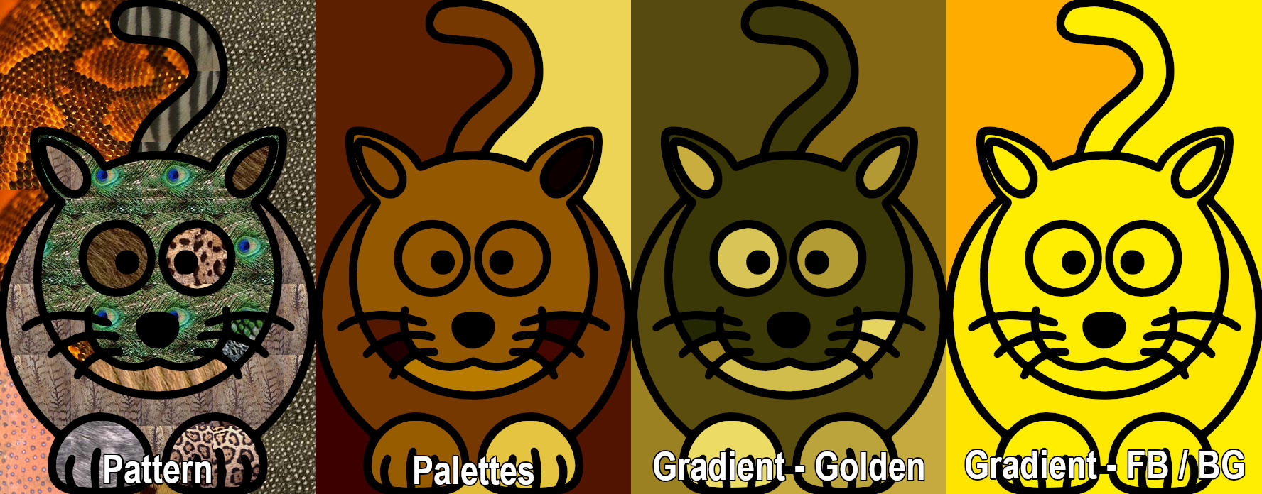

The script is running light and as expected, with a little note for the Gradient option of BG/FG Colors.
When selecting FG/BG colors for Gradient, there is repeatability in the output produced, the random feature does not seem to be taken into account in this case, and only two areas were continuously painted (at least in the image I used as an experiment). Always giving the same shade of red (orange) and yellow.
Dinasset, the way the selected gradient is producing its result is very satisfactory (except when selected FG/BG rgb), but it would be possible to have a second option, where the painted result would be shown in gradient rather than in solid colors of the selected gradient?
If only one of the two options is possible, I would prefer the way the script is now. As in the sample - Gradient- Golden from the image below.
Thanks for extending the life of this script and for the 7-animals patterns available.

I'm not an expert of Bimp, but I presume the numbers it wants differ in each installation (i.e. depending on which palettes, gradients, patterns are installed in the specific user Gimp)

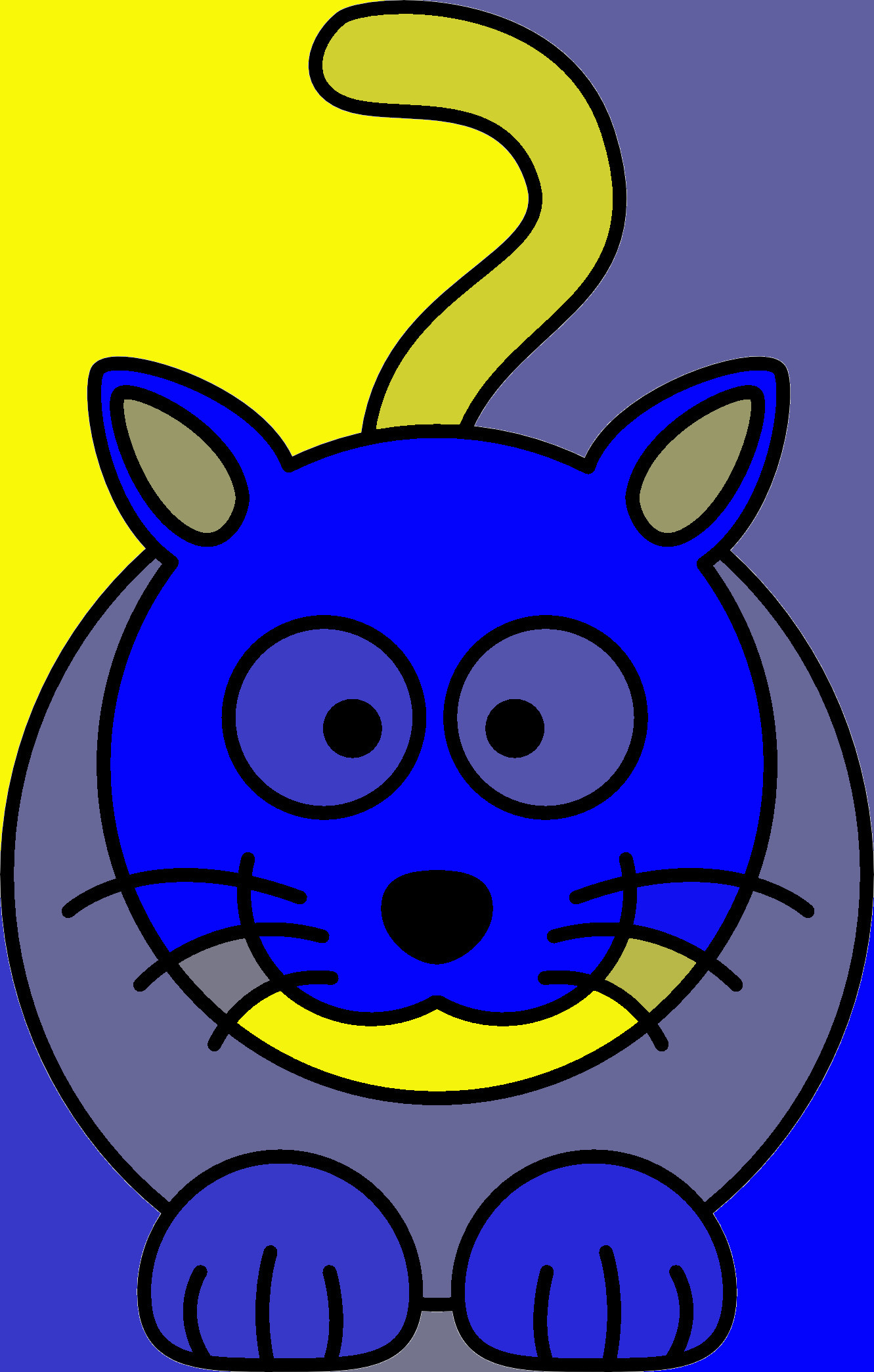

FG=FFFF00, BG=0000FF

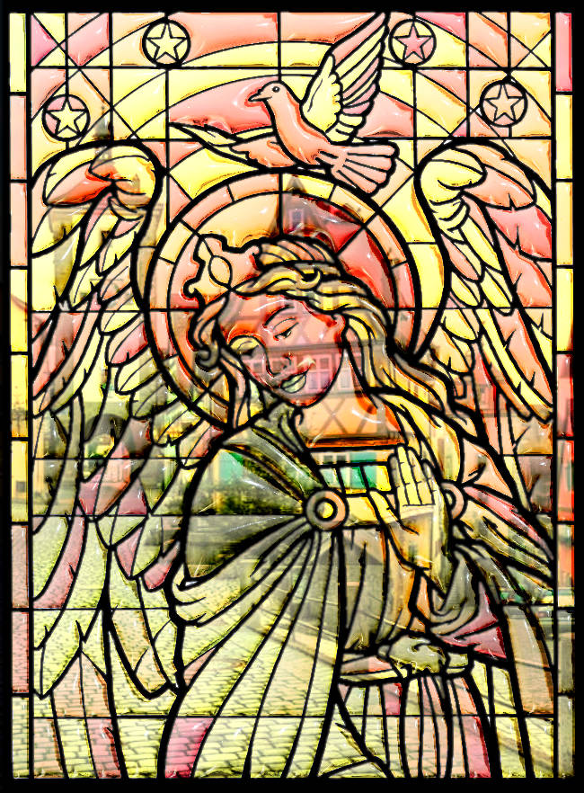

Sorry...
Found errors in my script; could you try now?
This is the amended version:
The attachment DIEGO_RENDER_Filling.zip is no longer available
What was good now is even better!
Dinasset, thanks for your efforts to improve this script and meet Gimpmaniac's wishes.

Dinasset could you please take a look at that bimp thing i mentioned?
When i try to use it in the dropdown i can only put numbers, not text. I just want to fill everything with patterns, the patterns are called meme (meme1,meme2 etc)
This will be a lifesaver for me.
Thanks a lot for your great work
 Post subject: Re: Multi-Fill Script Help
PostPosted: Wed Oct 09, 2019 11:28 pm  (#152)
As I told you, I do not know BIMP, but -if for pattern it requires a number- this means clearly that it accepts just ONE SINGLE SPECIFIC pattern for parameter (for instance: the ninth in the list), therefore it is not possible to specify a string (like "meme") to select randomly among all the patterns having that specific string.

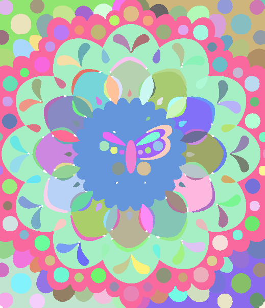

Quick question diego, do you have any idea on why this is happening? check the following photo
As you can see there´s a white border around the shape form.
Another question. If i use white and black and define white as the color to be replaced there´s a strange error where the pattern whites are also deleted. If i use green that doesn´t happen.
One suggestion. I think it would be great to give the possibility to remove the black lines right after the filling proccess is finished, it would be very helpful.
Thanks a lot in advance, you are very kind
Have a nice day
PostPosted: Thu Oct 10, 2019 11:28 pm  (#158)
Problem 1:
It happens often, because the source is not "really" black and white.
Ensure the source is really black and white by running "threshold" first.
This is my outcome using Nidhogg's image after having applied threshold before running filling.
As you see, there are no white margins.
Problem 2:
I don't know, post your sources (both the black and white and the black and green)
Problem 3:
Replacing black with what?

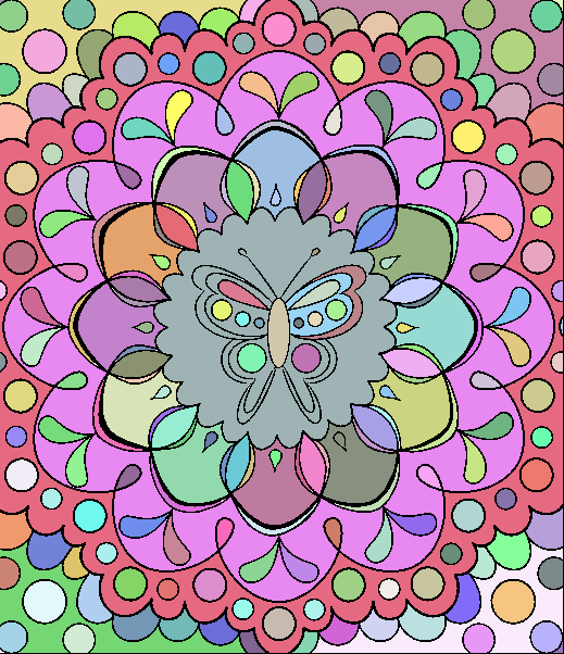

Because we live in different time zones, I took my decision without waiting for your reply.
This version removes the drawing lines (even if of different sizes).
Check and let me know.
DIEGO_RENDER_Filling.7z [2.25 KiB]
Downloaded 113 times
Outcome:
