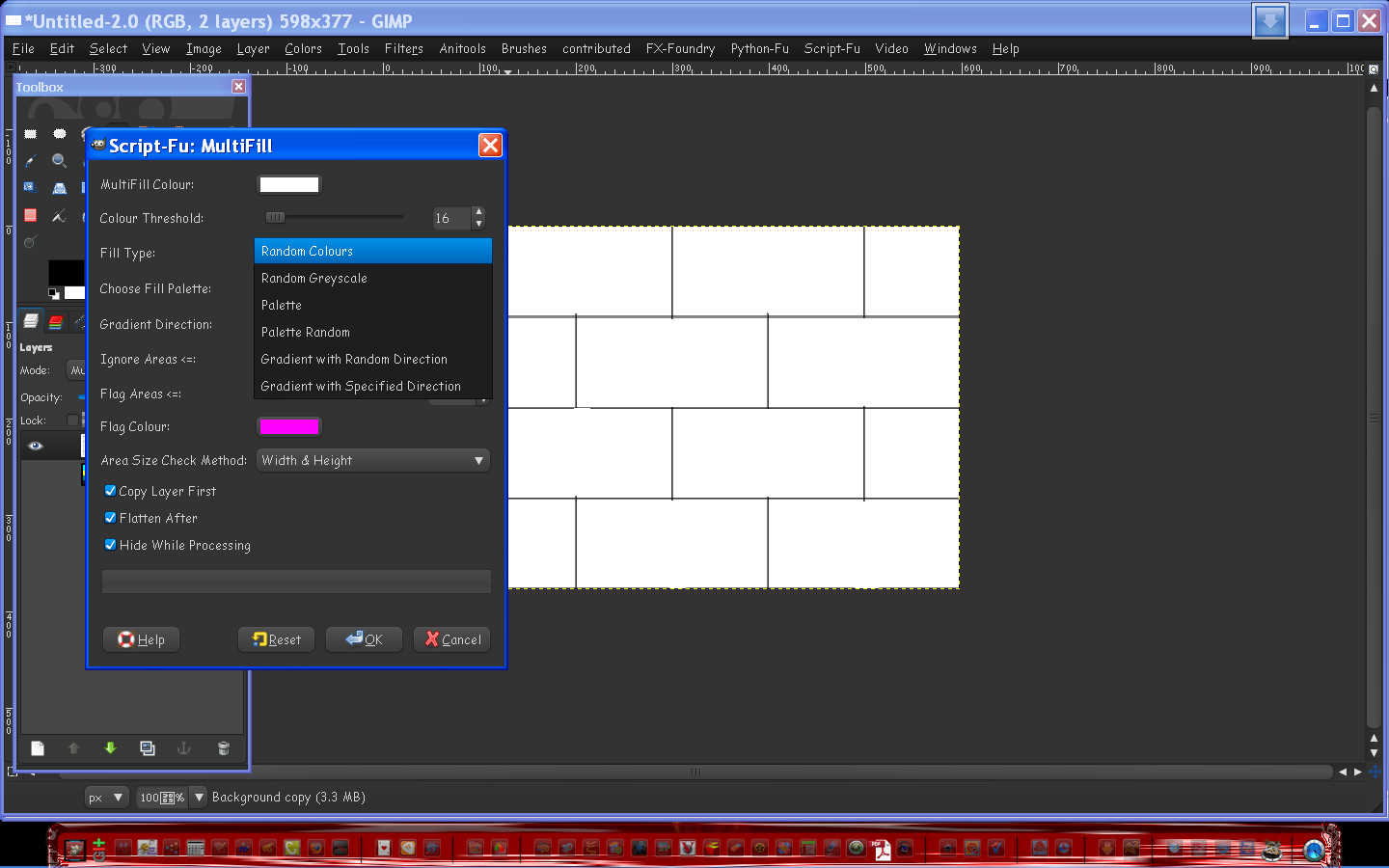

Here's a video of the script in action, this is mainly for those of you, who are keeping an eye on things:
(As always, best viewed on YouTube in fullscreen mode)

This is using the original script with a brick wall on palette setting (just for verification, random colors works as well, just didn't see the need to post two images):
Whoa, didn't see your post RobA. I was just feeling like I was biting off more than I could chew with something of the pattern fill magnitude.

You don't select anything first.
The colour parameter is the selection. It makes its own selection, then break it apart.
The default settings will work with black lines on white, all one layer as if you scanned a drawing in.
-Rob A>
