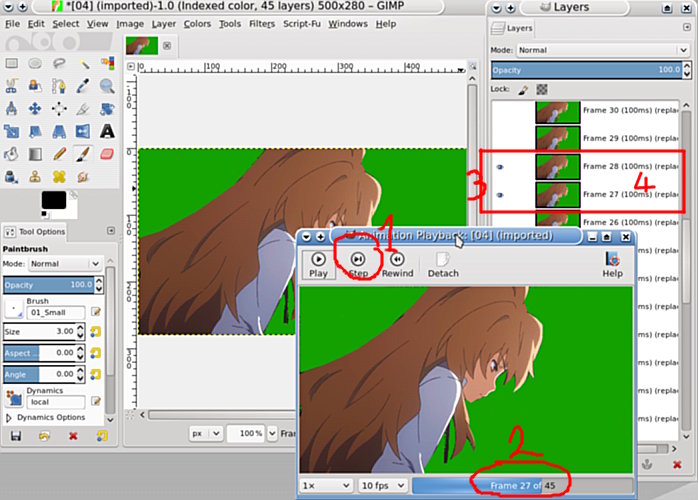

Normally these temp files I use are in a ramdisk and vanish but as luck would have it, still have a gif ;)
It could be a duplicated frame(s) where you joined the 2 gifs.
I can not see anything much wrong.
Playback the gif: Filters -> Animation -> Playback Step through a-frame-at-a-time (1) until you come to the hiccup (2).
Check in the layers to see if the frames are identical (3) Toggle visibility on/off will show this.
The other possibility is a timing setting. If the frame has a larger timing value there will be a pause. (4)

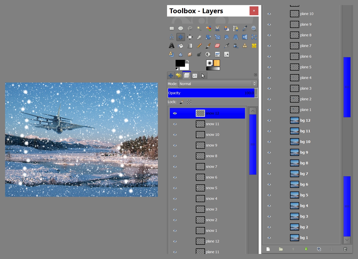

I had a couple of problems merging gif files when I started making animations, I got round these by creating all the layers to be worked on as .tif files, and saving blocks of these layers as .xcf files. I only create a gif as the last step in the process after merging blocks of .xcf files by using the script below
assemble-layers.scm [2.48 KiB]
Downloaded 116 times
located at Layer > Stack > Assemble for gif
I can’t say this is the correct or best way to make gifs but it works for me.
As an example, 3 blocks ( bg.xcf, plane.xcf and snowflakes.xcf ) each containing 12 layers are loaded into gimp, as shown in the screenshot ( the main image looks messy because the 12 snow and 12 plane layers are mostly transparent ).
When the script is run the user is prompted to enter the number of blocks (here 3), and the 36 layers are first shuffled into the correct positions and then merged down into 12 layers ready for saving. After saving as a gif file and run the result is as below
Ps If when the script is run the foreground colour in the toolbox changes to red, it means the number you entered will not divide equally into the number of layers and so the script cannot run

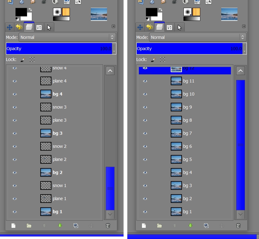

If you look at my first screen shot two posts back you will see 36 layers. The top 12 snow layers have a lot of transparency, the middle 12 plane layers also have a lot of transparency, whereas the bottom 12 background layers are solid with no transparency. When my script is run on this image of 36 layers it does two things, first it re-arranges the layers as shown below left with each solid background layer having two transparent layers placed above it, secondly it merges each pair of transparent layers into the solid background layer below them as shown below right. It is now saved as a .gif
