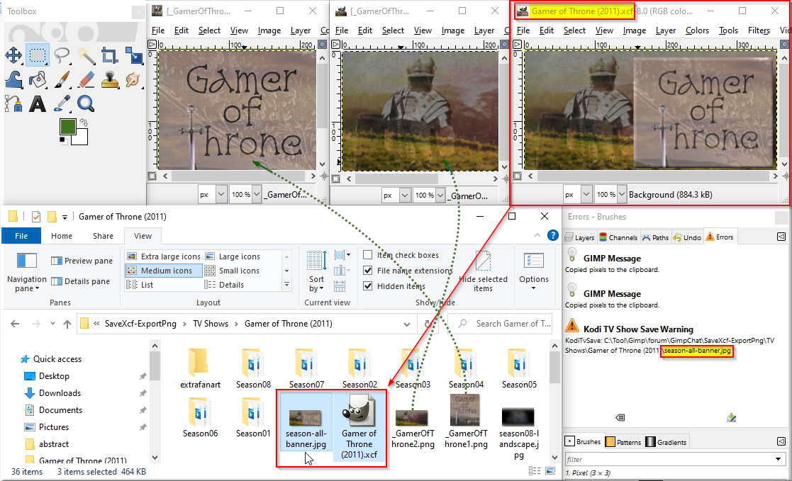

kittmaster wrote:
images located in "C:\Users\chris\Desktop\Kodi\1883 (2023)", load image file 1, load image file 2, merge 1 and 2 into template (banner
So merge 1 and 2 should be in the same folder than the last loaded image 2.
kittmaster wrote:
Create new image
This the new operating mode.
In all previous screen captures in page 1-2, the first step was a drag-and-drop: so the target picture had always a title.
When you create a new picture, the image has not yet been saved and its title is: "Untitled":
KodiSave 1.5 introduces the new function SearchFilename starting from the target image having merge 1 and 2.
If the filename is empty, SearchFilename searchs in the vector of all loaded images then choose the last loaded image having a non empty filename.
In our case, it is picture 2 with a green frame.
The SearchFilename code begins to be complex with three levels of let* :shock: including a loop in the vector of image id.

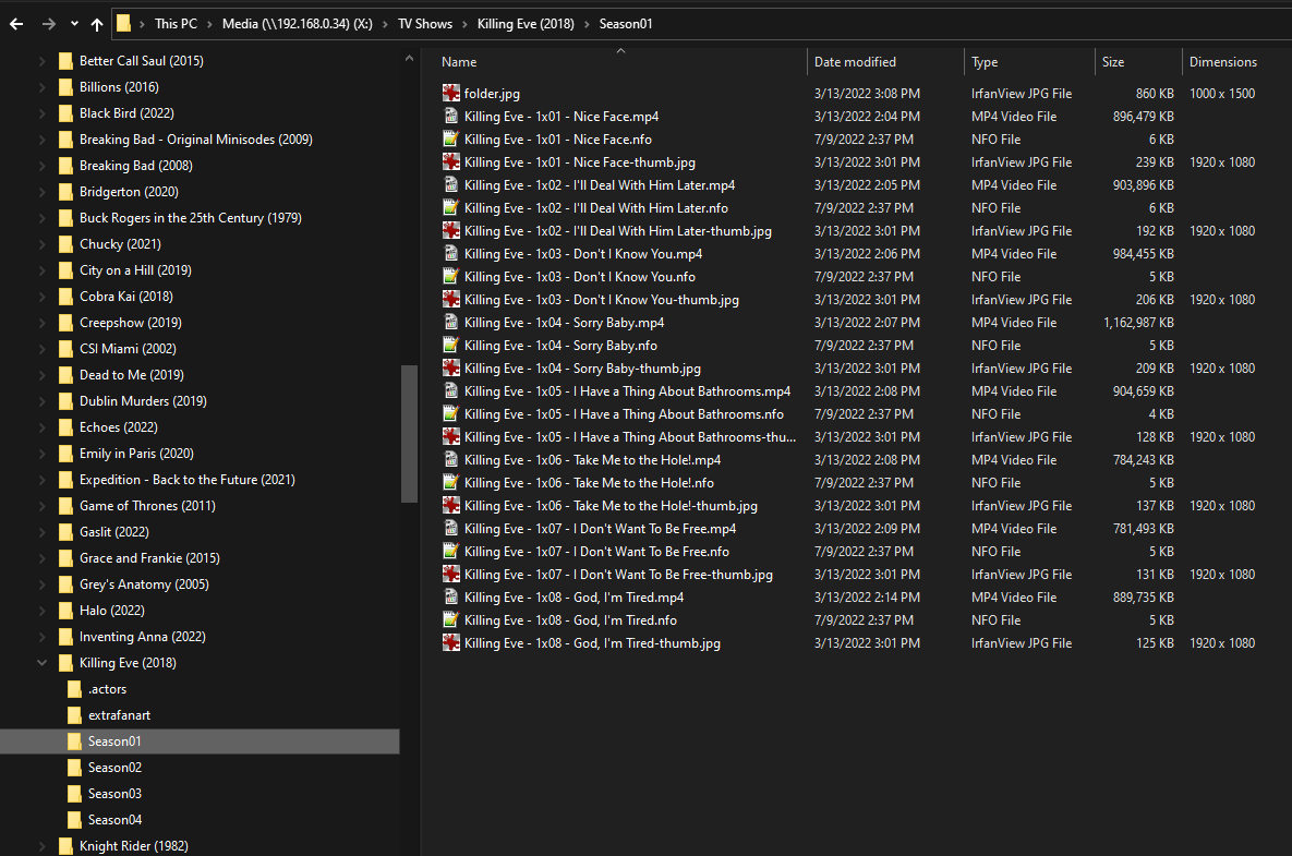

Just tried 1.5, works exactly as expected!! :)
You asked about what additional code could be added and now that everything is sorted, there is another helpful feature set within Kodi to operate on.

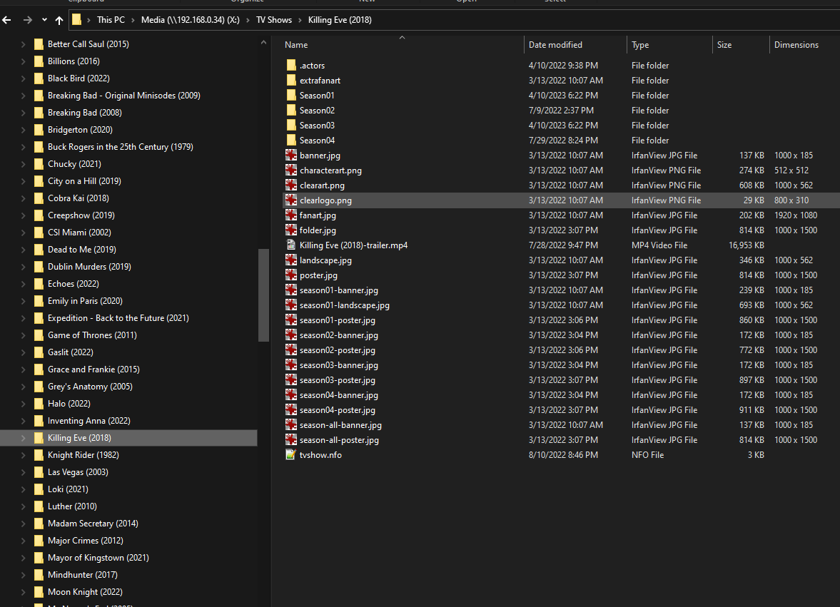

Everything thus far has been for "Movies" and its file and folder requirements.
The other major side to Kodi is "TV Shows" and these follow the same type of artwork methods but the folder structuring is a bit different because of the way "Seasons" are handled. Where Movies is a one off in terms of the movies folder naming and location of the art, TV Shows share a hybrid of this with some minor variation and some conditionals.
In the world of Kodi, most structure their files in a root directory. In my case X.
So, my folder structure looks like the images attached below: >>
Using the images as a guide:
--There are no needs for the .actors folders as those are scraped by the media program and placed automatically.
--The fanartXX images you can see follows movies, but it is added to a folder that needs to be created called extrafanart
--The poster, characterart, clearart, fanart, folder, landscape, poster are of the MAIN SERIES overview and remains in the TV Show named folder
--The root of the TV Show folder itself contains the seasons artwork... with the caveat that the season numerical number requires the leading zero to allow Kodi and the media program to match and display the artwork correctly.
Everything else is derived via the media creator program like the nfo, trailer, etc etc.
So that is the additional feature adds that would be nice to haves if you're up to adding them in. As it stands, the engine script you created can be used and clean up can be done manually if you have reach the end.
Let me know your thoughts?
Thanks again for taking the time... truly awesome work.
Chris

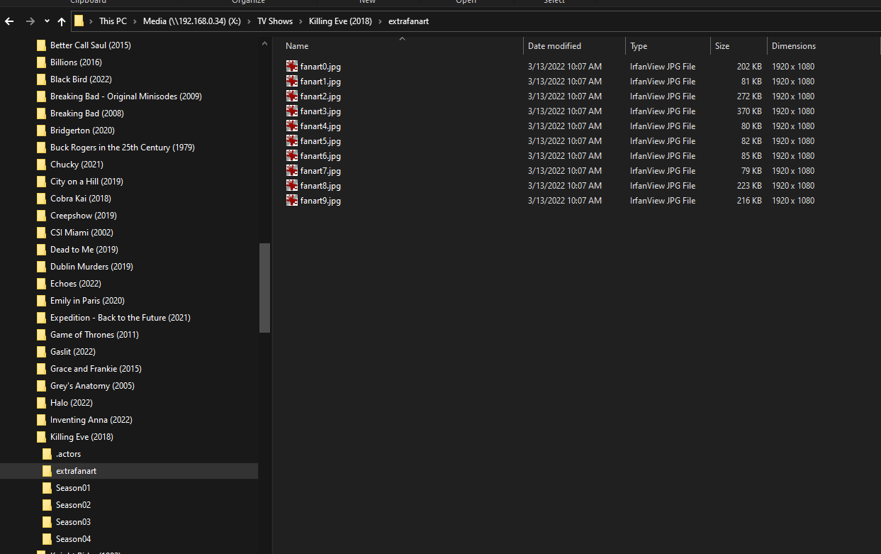

File comment: TV Show folder Root within Root folder called "TV Shows"
File comment: Fanart

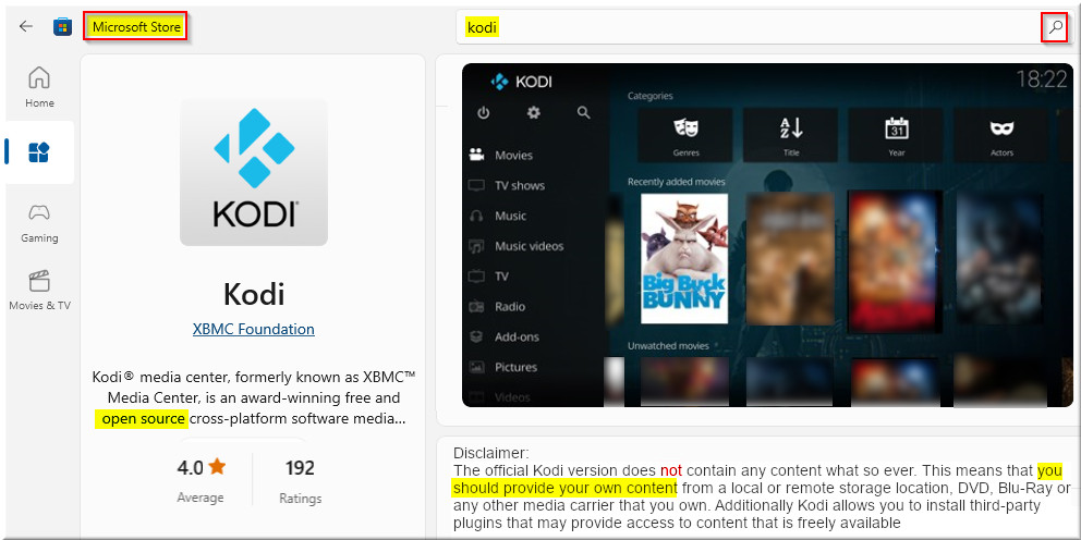

kittmaster wrote:
While Kodi has a bad rap about illegal stuff, their charter changed. It really does a great job as a media server.
Kodi is available for download in the Microsoft Store searching the keyword "kodi".
This means that Kodi is a legal application for Windows 11, into the bargain Kodi is a free open-source application.
In fact, it is an empty container without any media. As the disclaimer says, "you should provide your own content".

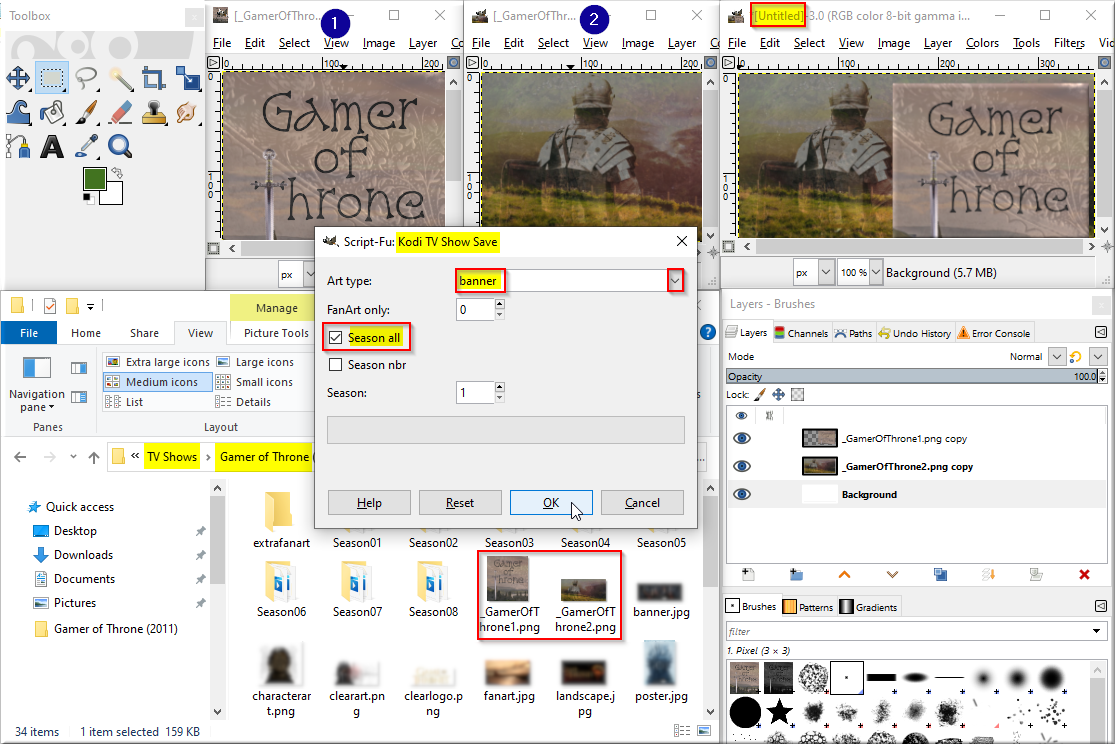

Script-Fu-based KodiSave is a Gimp 2.10.34 plug-in that allows to save untitled image composed with multiple layers in both .xcf and .png or .jpg on option:
in the two last cases, the layers are merged automatically.
Contrary to the legacy Gimp menu "File" > "Save", you are not asked to provide:
  • a folder since the target folder comes from the last loaded image copied as layer in the target image;
    KodiSave never creates any folder. The target folder must already exist.
  • a filename because it is deduced from miscellaneous options in the dialog box.
Two menus are added in the Gimp "File" menu:
  1. "Kodi Movie Save" (Alt+F K) compatible KodiSave 1.5
  2. "Kodi TV Show Save" (Alt+F V) introduced in KodiSave 1.6
    If you do not wish the "season" prefix, do not check one of the two checkboxes.

 Post subject: Kodi TV Shows Save 1.7 usage
PostPosted: Sun Apr 30, 2023 11:47 am  (#35)
Joined: Oct 23, 2021
Posts: 67
  1. Open image 1 from anywhere.
  2. Open image 2 from the top level folder of a TV show.
  3. Create a new image: this is the empty target in which you can copy completely or partialy image 1 and 2 as layers.
    Opening image 2 directly as layer in the new target image --skipping step 2-- is an unsupported operating mode.
  4. Gimp menu "File" > "Kodi TV Show Save" (Alt+F V)
Beware when you close image opened from the hard disk. :sneak
If you can close image 1 or not at any time after the paste in the target,
while the empty target has the "Untitled" title,
be sure to keep open the last image 2 used to compose the target even after the paste in the target.

 Post subject: Re: Shortening mouse/keystrokes save/export script or method to implem
PostPosted: Mon May 01, 2023 11:08 am  (#36)
Joined: Dec 27, 2022
Posts: 22
Operationally 1.6 is a looking sharp!
I ran through both sides and only a couple of minor operational changes if possible:
Movies:
Fanart Generation >
--if it is "fanart.jpg" only, no numbers, it remains in the Movies' root folder
--if it is "fanartXX.jpg, with any numbers, A new folder named "extrafanart" needs to be created within the Movies' root folder; inside folder "extrafanart" > each file as named: "Fanart 0.jpg", "Fanart 1.jpg", no movie title or year prefix.
Post image named -- fanart -- shows exactly description needed for modification:
viewtopic.php?f=8&t=20332&start=30#p279330
(I may have misspoken early on about this one, operationally script is solid, I may have had wrong path and naming identifiers/location incorrectly stated > assumed images spoke to that, my apologies)
If this can be corrected, Movies operation will be 100% complete.

Saving Kodi skins has a tree of folders of a big complexity. :faint
At the top level, you can save Movie or TV Show but also probably more
like in a chess game after the opening of the White pawn of the King: 1. e4
vs. the advance of the White pawn of the Queen: 1. d4
At the next level, you have a branching factor of 14 :evilgrin corresponding to each art type
like the different answers of Blacks in chess such as Sicilian 1... c5 after 1.e4
However depending of the top level choice, there are miscellaneous differences
between the art type of movie vs. those of tv show such like movie "fanart" vs tv show "extrafanart". :tomduck
Rules are unregular: fanart0 does not exist in movie but exist in tv show. :gaah
The notion of seasons introduces a new dichotomy in the root of a tv show.
The numerical season number has a leading zero but not the fanart.
Into the bargain, season suffix could include "-all" instead of the season number. :mcof
