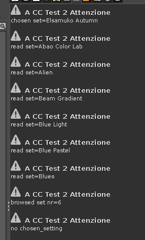

PostPosted: Sat Jan 27, 2024 10:12 am  (#30)
Posts: 14831
@tin
created a second process inserting what you suggested;
inserted traces;
it seems that the load loads only 6 presets, then stops
any idea?
 Post subject: Re: use of a color curves preset in a python filter
PostPosted: Sat Jan 27, 2024 10:29 am  (#31)
Posts: 14831
If choose to load "Alien", the preset is applied because it is inside the 6 presets read.
So, the only thing strange is that the process "load" loads only 6 presets.
@ofnuts
any idea?
PostPosted: Sat Jan 27, 2024 2:50 pm  (#34)
Joined: Dec 09, 2018
Posts: 732
Your seventh preset, "Bright Red" is failing in the green channel as it has numbers of format 9.7999999999999997e-05
The regular expression in funtion readChannel didn't support exponents so try changing this:
      samplesString=extract(r'\(samples \d+ ([0-9. ]+)\)',samplesLine) # skip count value
to this
      samplesString=extract(r'\(samples \d+ ([-0-9.eE ]+)\)',samplesLine) # skip count value
PostPosted: Sat Jan 27, 2024 11:11 pm  (#35)
Posts: 14831
Thanks teapot.
Changed as indicated and now all presets are browsed.
Only left error at end, I will try to understand.
