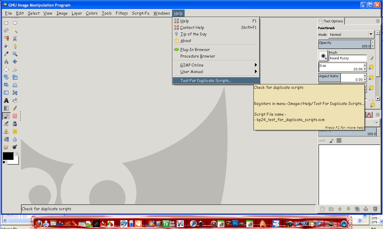

I've hacked at my script a bit more. Now it gives you the option of checking all the scripts in all the directories you have defined in Edit >> Preferences >> Folders >> Scripts
It is also now checking properly where there is more than one script defined in a .scm file and I've made the progress bar keep you informed of how much is done.
Test For Duplicate Scripts Warning
duplicate: script-fu-kp24_webname in
D:\Profiles\kevin\.gimp-2.6\scripts\mine\kp24_webname.scm
and
D:\Profiles\kevin\.gimp-2.6\scripts\kp24_webname.scm
Finished. Found 169 register attempts
If this looks OK (and I'd welcome any comments about enhancements/coding style) then I'll upload it to GimpScripts
Kevin
p.s. My version still registers in a "contributed" menu. Edit the first line to put it where you want:
(define selfmenuroot "<Image>/contributed")     ; Change these to suit yourself
change to
(define selfmenuroot "<Image>/Help")     ; Change these to suit yourself
to put it in the Help menu for instance
(Personally I wouldn't put it under Filters because it doesn't do anything to an image)

Perhaps a better menu would be help>check for duplicate scripts
zip attached with menu fix
kp24_test_for_duplicate_scripts.zip [1.83 KiB]
Downloaded 99 times

PostPosted: Fri Nov 11, 2011 5:07 am  (#40)
Thanks Kevin. I think in the help menu is a perfect place.
