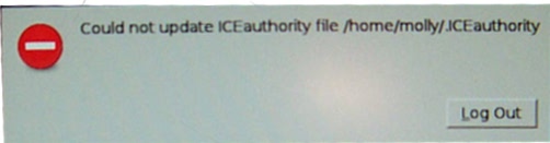

Everything went whizzing by and I could see where it kept saying changing ownership or something like that. so I thought I had it made. I typed in exit and rebooted it and then I saw the pink screen then a box came up to type in my password. I did that and I got that same error that I got at the very beginning.
I tried that about 6 times and kept getting that error. I could get in as a guest but I didn't want that. When I tried to close it, it wouldn't close no matter what I did so I had to use the switch. Dam.

Okay, I did the chown -R molly:molly /home/molly/.*
Can you post a pic of the exact error message? Maybe we need to search for all instances of .ICEauthority.

That's a different error. At what point do you get this error?
That tells us that the file can't be updated (during bootup?). Will have to investigate further...

Tux I get that error above after I did that last command that changed the ownership.

cannot access ICEauthority - No such file or directory. Maybe I should try to take the whole thing out and install Fedora. I dunno.
You must have mistyped something because we know that .ICEauthority exists. Make sure there are no spaces in /home/molly/.ICEauthority (it's also case sensitive).

Do you get that last error message after you enter your username and password, then your only option is to logout?
 Post subject: Re: Can't open Ubuntu
PostPosted: Thu Jan 05, 2012 11:38 am  (#40)
Yes I do and I can't even log out, I have to turn off the switch to get out.
