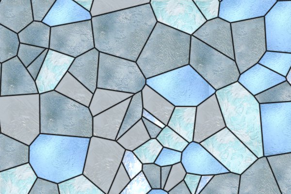

OK - a couple of teasers:
And the code is attached since it is a big big to inline.
So this version looks for case insensitive jpeg, jpg, png, bmp and pat files. it creates a new invisible image, then loads all the files as layers and randomly sets the fill from those using the clipboard then destroys the temp image. Two One things:
1)it destroys the clipboard contents
2) the clipboard only supports 512x512 px patterns max.
-Rob A>

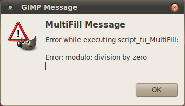

Getting this error:

I'm still getting the same error. Hmmm...
 Post subject: Re: Multi-Fill Script Help
PostPosted: Tue Mar 01, 2011 4:23 pm  (#54)
In investigating "modulo" I only see two instances of it in the palette option, and when I run the Palette option, it works fine, it's only when I use Patterns, it fails. I'm just blabbering because I am curious as to why modulo is having division by zero errors, when different options are used.
All the other multifill options work. I've even copied a pattern to the clipboard in advance, opened a pattern and copied, etc.
Another strange behavior is the SF-DIRNAME option on the multifill menu, each instance of opening it, it changes locations: (example being, each time I open the script for use, the location will be either - .gimp-2.6 or mahvin or patterns. It never remains consistently on one directory location, is this normal?
PostPosted: Tue Mar 01, 2011 4:44 pm  (#55)
Another question: Since I am using this in Ubuntu, is there a slash direction issue with directories?
string-append has them as backslashes, but Linux uses a forward slash.
EDIT: It didn't make any difference, modulo division by zero error persists.

Joined: Apr 23, 2010
Posts: 1553
If you use slashes in Script-fu, the interpreter should perform any necessary conversions (though I am not certain of this since I don't typically use Windows). The best solution is to use the DIR-SEPARATOR constant.
In RobA's latest offering, try modifying all "\\ strings to DIR-SEPARATOR " strings (note that the quotation marks are included in the strings being specified). For example,
        (set! varFileList (append varFileList (cadr (file-glob (string-append inDir "\\*.[pP][nN][gG]") 1))))
becomes
        (set! varFileList (append varFileList (cadr (file-glob (string-append inDir DIR-SEPARATOR "*.[pP][nN][gG]") 1))))
PostPosted: Tue Mar 01, 2011 6:17 pm  (#57)
YAY! That fixed it for Linux! Woohooo! Thank you, Saulgoode! And a big big thanks to RobA for getting it to this level.
