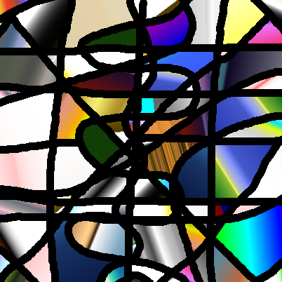

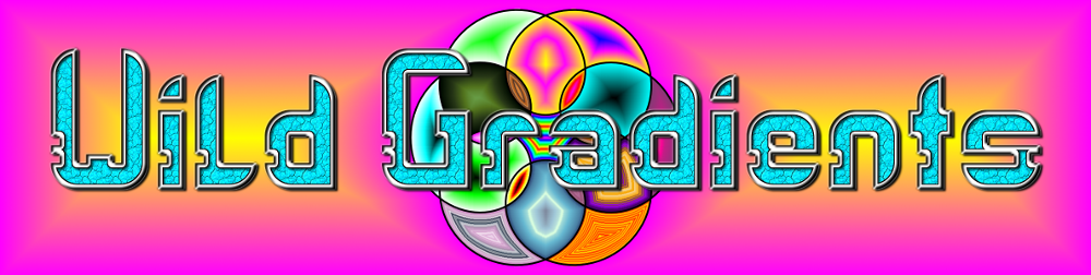

PostPosted: Fri Mar 29, 2013 11:07 pm  (#67)
Here are 2 off my images, 1 using patterns, and 1 using gradients
Patterns from one of my gurn folders
Using random gradients
to get the result from gradient choices I slightly modified the script

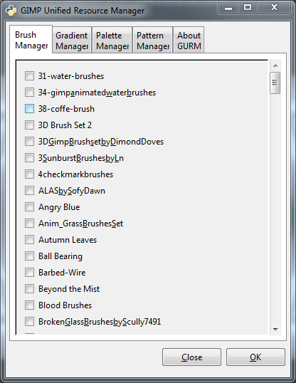

Gurm is a very good program for storing your additional brushes, patterns, gradients, and palettes
it's another great program from RobA Available here

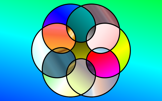

because I feel myself uncomfortable with having the mentioned messages show up only with the draw created with the Pursuit and not with a draw hand made by myself, I did a lot of experiment, increasing at each run the complexity of the drawing, and eventually I got the same messages about GimpPdbProgress callback also using my drawing.
I don't understand whether this happens because of the number of areas or the too many different area sizes, anyhow I attach here the original drawing and the filled one (result is always OK); if you both can experiment trying to multi-fill my original with option gradient, let me know your results, thanks.

Two examples, one of each gradient fill option, with similar results to yours.
The same Gimp error message each run of MultiFill with gradient option on your image.
GIMP Error
Unable to run GimpPdbProgress callback. The corresponding plug-in may have crashed.
GIMP Error
GIMP Error
Gimp 2.8.6, Win32, MultiFill
