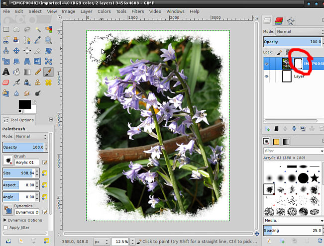

Really, although a pre-made frame or a plugin can be used, it is easy enough to add a mask then paint out the edge with a suitable brush.
