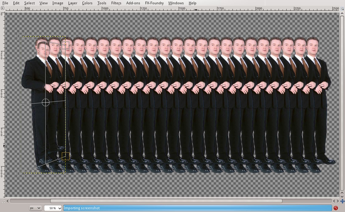

Relatively easy way:
  • open picture with character
  • duplicate N times by clicking frantically on the "duplicate layer" icon
  • use your mad python skillz to spread the copies uniformly by entering the following exactly in the python-fu console:
    # this assumes one single image opened in Gimp...
    image=gimp.image_list()[0]
    # shift each layer by 80 pixels
    for n,l in enumerate(image.layers): l.set_offsets(n*80,0)
  • chain all the layers together (shift-click on the link icon of any in the Layers list)
  • apply the perspective transform to the first, and try to extrapolate the intersection of the top and bottom line for your vanishing point
  • press the transform button
Edit: actually once you have spread the layer copies you can merge the visible layers and just apply the perspective on the single layer. But using separate layers seems to "naturally" keep the aspect ratio.
You mean your mad python skillz. :hehe
I've never done anything with the python-fu console before.
I did copy the code you posted and also entered it into the python-fu console, but that's as far as I got. Without any results.
Thanks Ofnuts. :bigthup

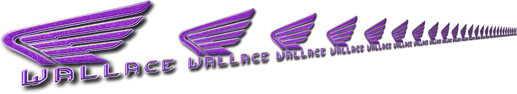

I'll post something else, showing that I did get the code to work.
Here's the proof that I got it to work...

I think I'm getting the basic use.
Still do not know how exactly align with the vanishing point. When I try, the image is very distorted in my attempts. But I've done some progress.
Credits to http://sk-digiart.deviantart.com/
Wallace your post motivated the creation of this script, so my thanks to you also. :tyspin
