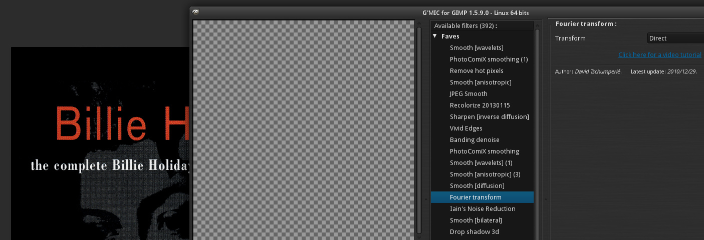

Hi,
I'm trying to figure out why this doesn't work on some images. When you click the FT filter from the list, it just displays a transparent preview.
I am using and RGB image and the other FT plugin "Descreen" still works fine so I know it "should" work. I've run into this a few times and just ended up using the Descreen filter instead, but I need the finer control of G'MIC in this situation and it would be nice to get to the root of the problem so I can fix it or learn to avoid it in the future.

That is because your image has an alpha-channel.
Try removing the alpha-channel before doing the FFT, and it should be OK I guess.
*Sigh*
I knew it was something simple, but that makes me feel really stupid. :oops:
Thanks Ronounours!
