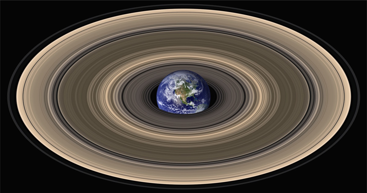

Use RobA's SampleGradientAlongPath script to using a path that crosses the ring, then use the gradient in a radial blend. You can then apply scale/perspective transforms to the result.

ofnuts great idea!
