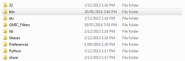

PostPosted: Mon Sep 01, 2014 2:29 am  (#9)
Sallyanne did you try using windows explorer to look for it, if you open your gimp folder it is right there towards the top like below

Funny I dont have a 'plain' gimp 2 folder anymore that I can see. Only 2 x 2.8 gimp folders. I found a 'bin' folder through doing a search but I think another program on my computer uses one too. BTW I don't have that 32 folder - not sure if I should have. And everytime I try to call windows explorer up - libraries opens instead which only has about 4 folders in it. Documents, Pictures, Music, Videos.

Looks like my 'view' was different so I couldn't see it. Found it in libraries or is libraries the same thing as explorer?
I found two bin folders and there was no zlib in either one.
