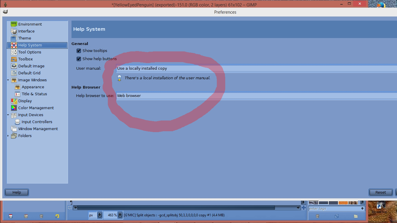

just change these options bitsnpcs

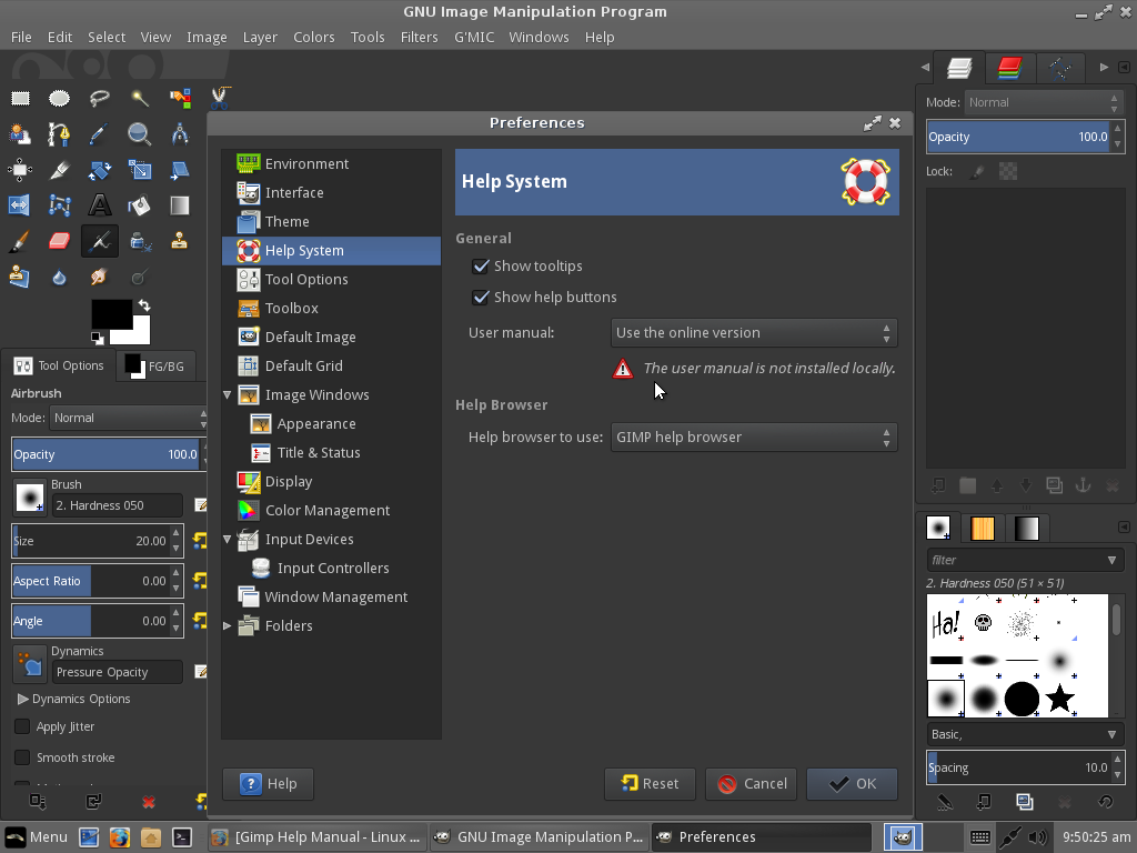

I have tried this and it give this error -
"The GIMP user manual is not installed on your computer.
You may either install the additional help package or change your preferences to use the online version"
Synaptic shows the help manual files are installed.
On your image where it reads - "There's a local installation of the user manual"
I have a red triangle and it reads - "The user manual is not installed locally"
Here are the screenshots of Synaptic showing help installed, and Gimp showing help not installed -

A couple of things to try.
change from system and specify the language.
Go into /usr/share/gimp/2.0/help/ and change the folder name en_GB to plain en
:bigthup Thank You rich2005 :)
The first one solved my error, change from system and specify the language.
