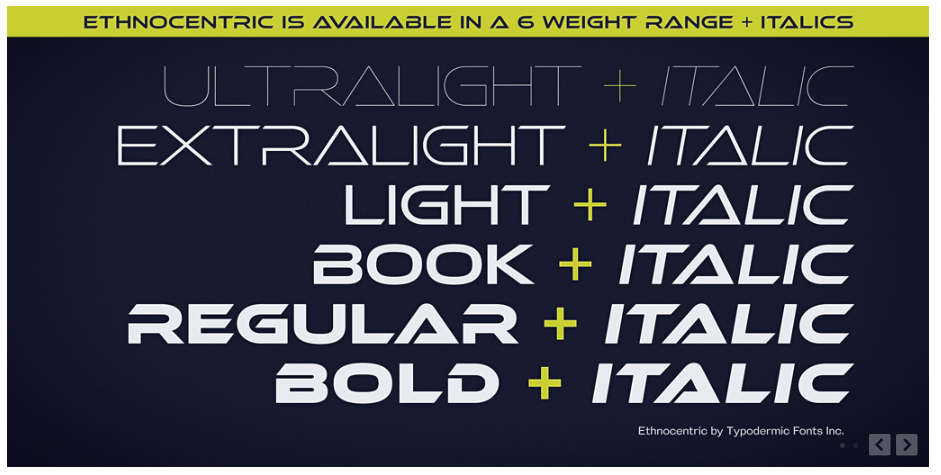

That's interesting.
This is an image of the Ethnocentric Font Family.
If anyone wants to get it here's the link to dafont.com.
http://www.dafont.com/ethnocentric.font

I installed Ethnocentric font and the script picked up on it. The only way that would work every time is if there were a font that came in Gimp with that name, which it doesn't.
