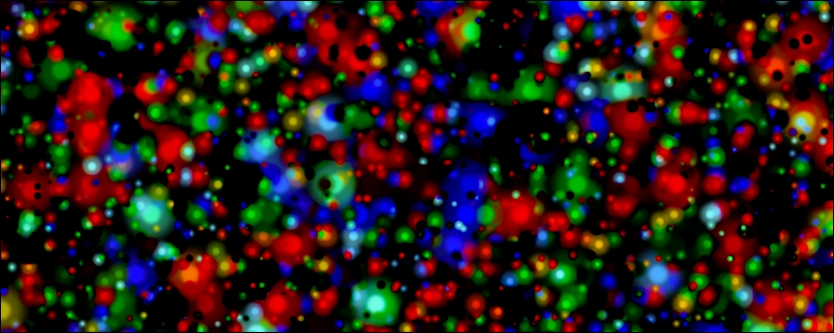

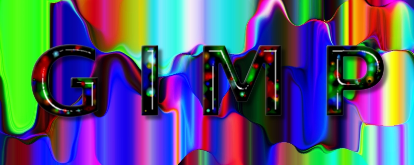

 Post subject: Re: Help with Splatter Text
PostPosted: Thu Nov 13, 2014 5:28 pm  (#6)
Another thing I can think of is text filled with paint splatters on a Bkg of dripping paint
Or you can create text on this type of Bkg where I have thrown paint onto a black canvas

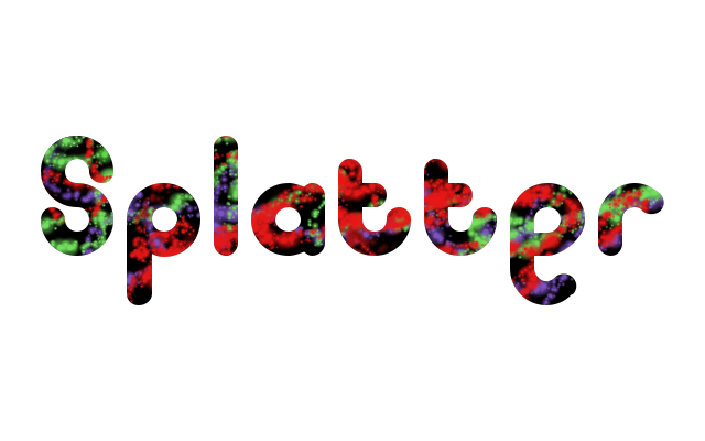

PostPosted: Fri Nov 14, 2014 7:25 am  (#9)
Posts: 16256
I would alpha to select the text layer and select the "Sparks" brush. Create a few different layers and you can Colors>colorize each layers sparks pattern. XCF attached. Hope that helps you.
splatter_RD.xcf [137.65 KiB]
Downloaded 107 times

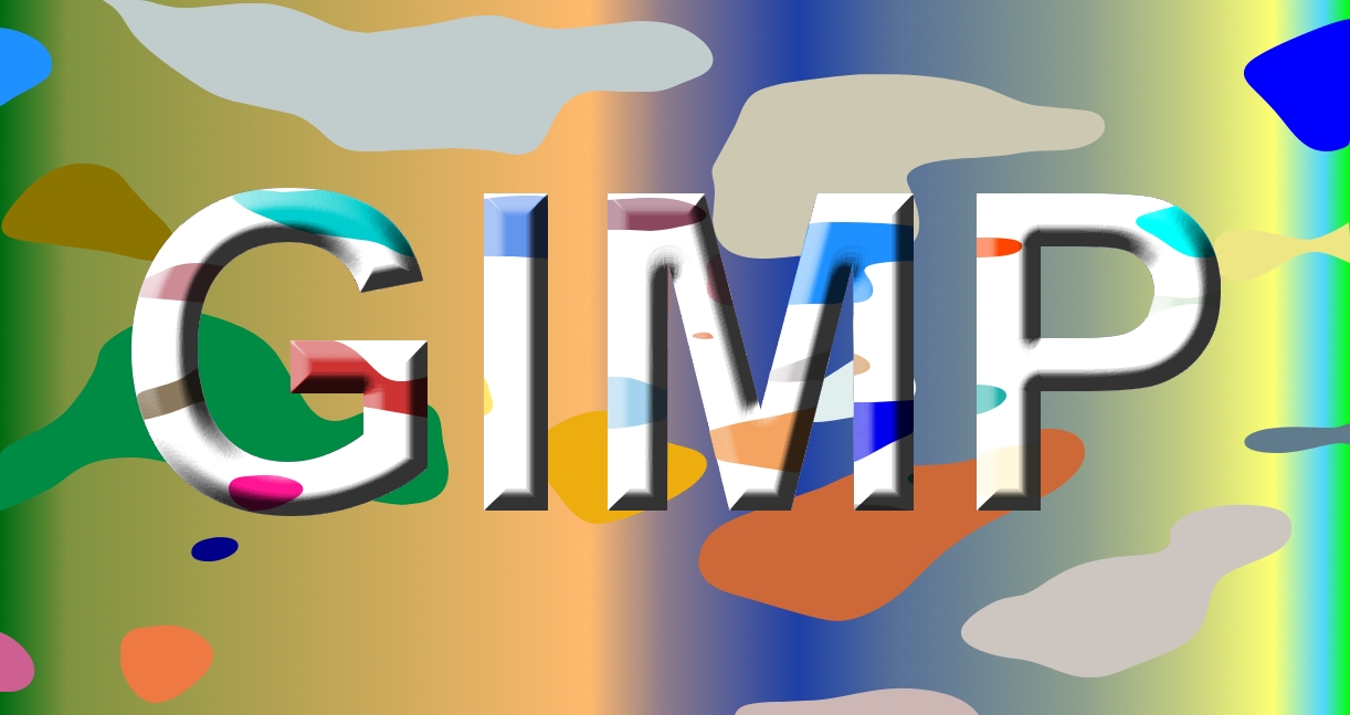

PostPosted: Sat Nov 15, 2014 7:53 pm  (#12)
This is another rough attempt at the image colors may not be correct
