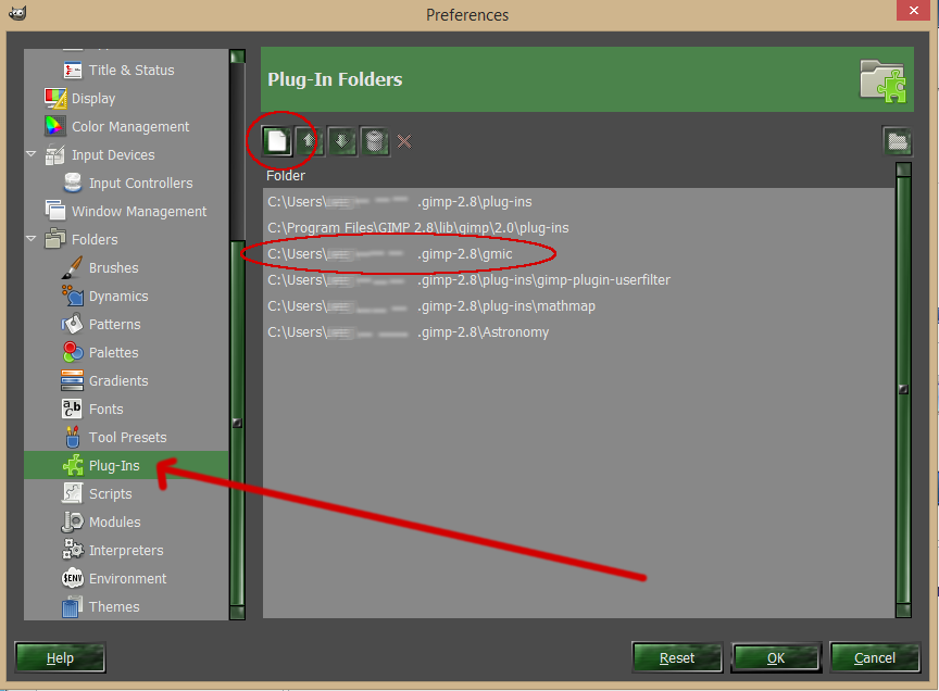

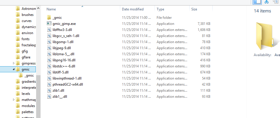

If you downloaded the zipped file, then create a directory (mine's called gmic) and place it in your user directory. Then add that directory to your plugins folder in GIMP (in edit menu, click on Preference option).

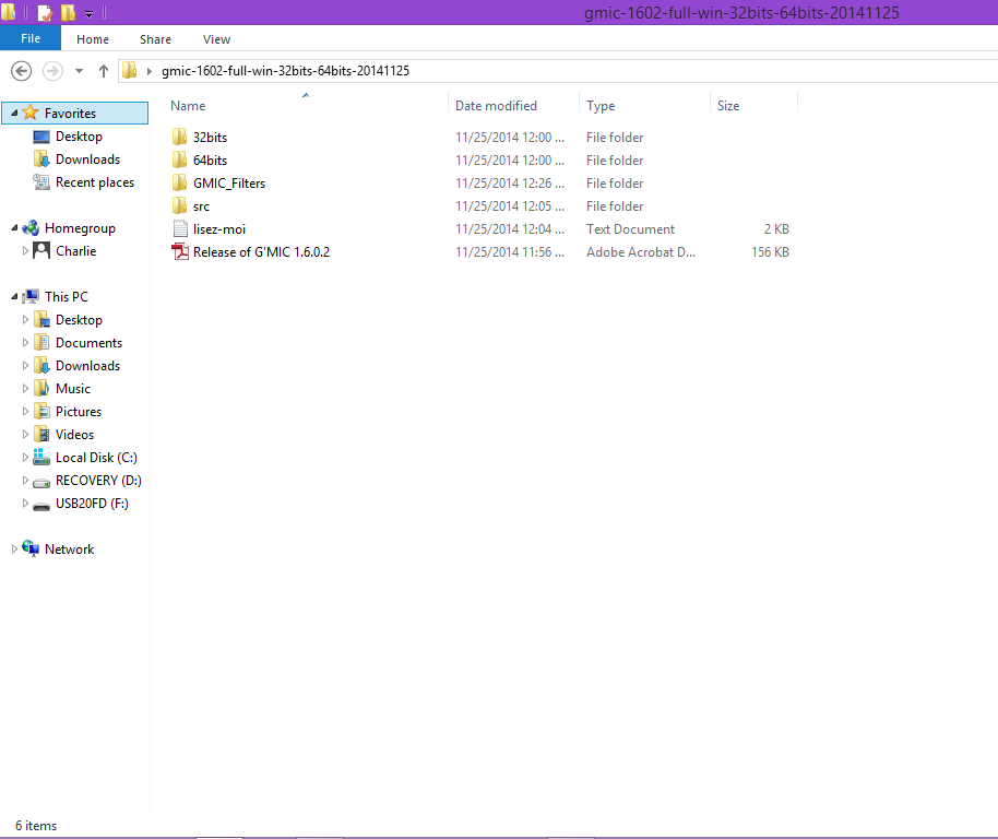

This is everything that came in the zip. Do I have to remove anything before installing (i.e. old version of g'mic)?

First I need to know what version of GIMP you are running (32-bit or 64-bit). :)

Maybe you have the plugin actually installed in the main plugin's directory. This became a no no when some of the DLL interfered with other plugins and it was recommended (well it had always been recommended but I was too bull-headed back in the day) to have GMIC run in it's own directory. Just need to remove GMIC from that directory and follow the steps outlined (used the contents in the 64-bit directory; it should look like the folder view that I showed) and all should work Charlie. After doing so, just launch GIMP and it should work. :)

I've really been trying to figure this out (I don't want to just give up). I made the directory in my 'user/*name*/Gimp 2.8' folder, and added it to my plugins folder in gimp like was instructed but still have v1.6.0.0. I apologize for not knowing what to do on this.
