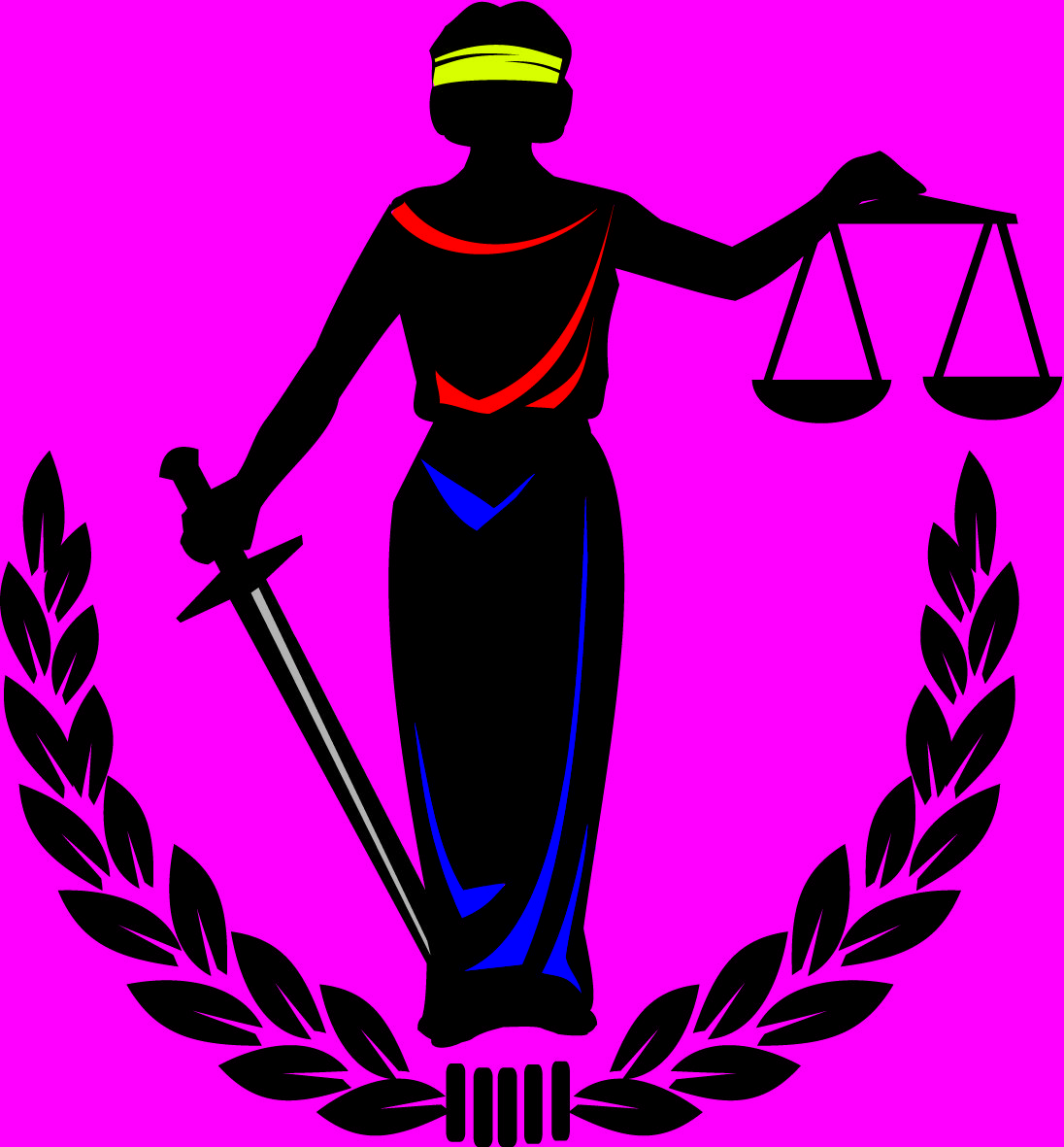

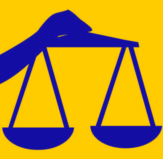

Still struggling. I'm trying to fill the transparent shapes in her upper body and head with blue. I can't select the area. I was able to select the areas in her lower body and successfully filled those areas blue. (Yay!) I have tried fuzzy select and select by color. I'm attaching the modified image.
Thanks again.

Always use the right tool for the task.
I'd use fuzzy/color select tool and the bucket fill just to recolor the shapes (black).
To color the transparent areas within those shapes I'd simply create a transparent layer behind
the shapes layer and use paintbrush tool - nice and clean, and no fuzzy edges - see the attached xcf file.
justice_paint_tool.xcf [642.86 KiB]
Downloaded 212 times
