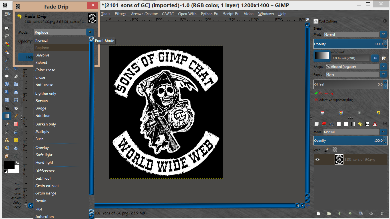

(BTW: why are they not available interactively?)
I believe these are available under the FADE option in the edit menu. Run a filter then run Edit>fade effect.

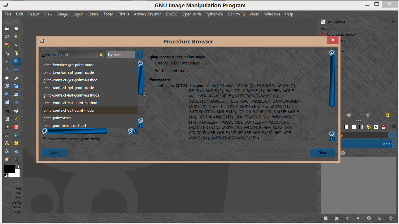

Posts: 16298
Found it in the PDB also. :)
