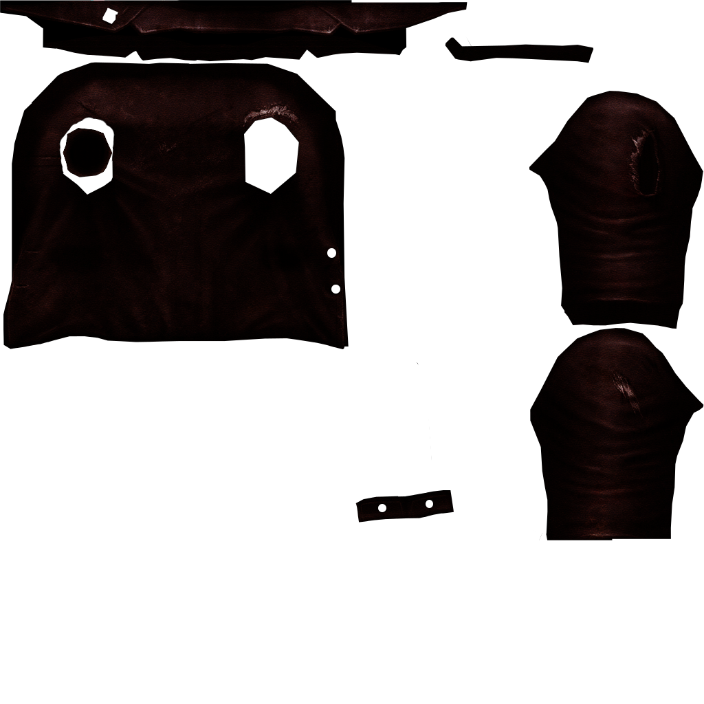

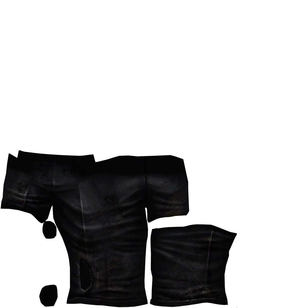

Hello everyone. I have some basic use with Gimp for a while, I have had this program for about 3-4 years now. Im still learning new things today (even if its just simple things).
I want to change this suit texture. The first thing is to remove the stripes, but i can't seem to find a simple way to do this. What I had in mind was to just one by one, airbrushing it out, but with all those lines, its going to take forever.
The 2nd is to change this suit texture into leather. I tried overlaying a leather texture from google but the shadowing and lighting are barley visible when merged, which just makes the texture look too flat on a model.
I have multiple things to do as of now, so any help, I would really appreciate it

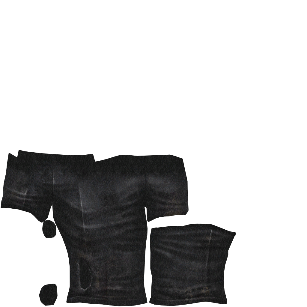

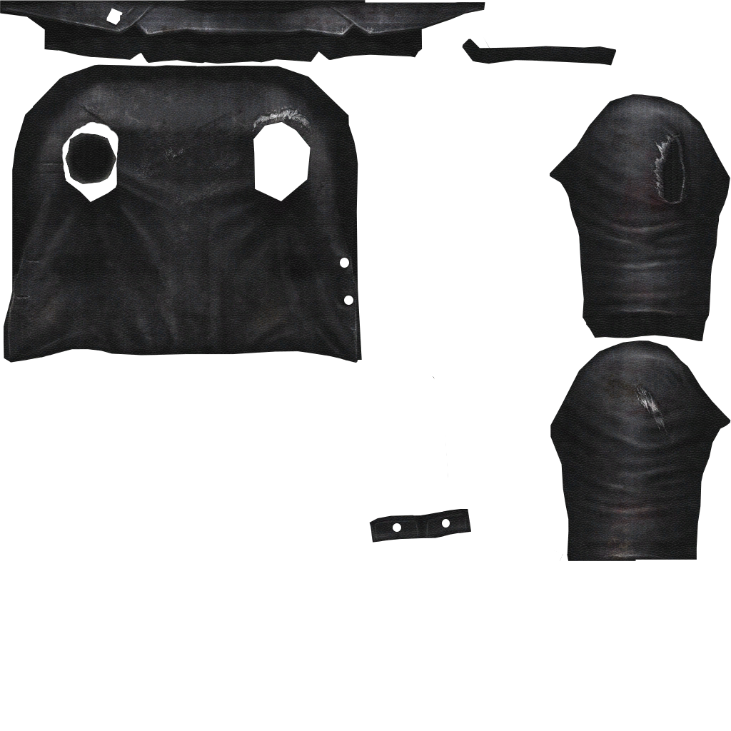

GIMP's own Filters > Enhance > Destripe... does an OK job on them, but for the main body of the coat, G'MIC's Repair > Unstrip filter did a better job. I locked the layer transparency, selected each region of the textures separately and ran either of those filters, playing with the settings until it looked OK. For the topmost region of the coat, I rotated the image 90 degrees before filtering.
As for making it into leather, well, the original texture looks like it's meant to be a dark but slightly shiny dress fabric, while leather might be shinier or duller (depending on treatment). Did you want black or brown (or other) leather? The starting point to editing it might be different depending on the goal.
File comment: Image posted by Im Not Stu, filtered to remove pinstriping from the suit texture.

I used the FFT/inverse FFT in G'MIC to clean up the pinstripe without much attention to detail :P, then a desaturated layer filled with the default leather in addition mode at 50% opacity.
