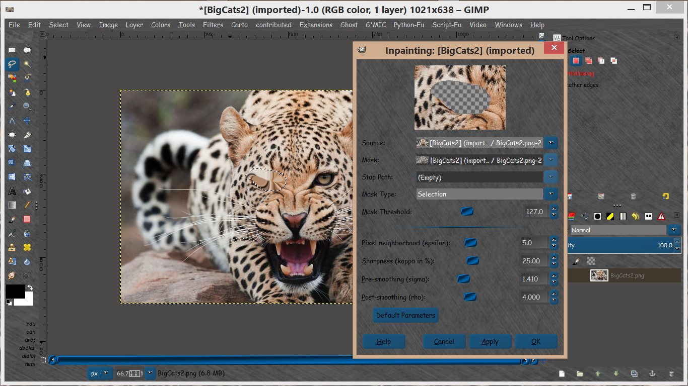

I have used the Inpaint[patch-based] to great effect (and also Heal selection having recently downloaded the gimp-plugin-registry).
However, I see that there are three other versions of Inpaint - [diffusion], [holes], and [solidify].
I would appreciate some guidance on the uses for these.

last time I had a brief search on your topic unable to figure out if this link would be helpful http://inpaintgimpplugin.github.io/
now I come back because that info was so fascinating to me that I couldn't forget.
would it work to remove this tree infront of the painting? to get the direct perspective (maybe I should post again with another example)

My first effort would be to composite the wall art from the first image onto the second, using Gimp's perspective tool to work out the inverse perspective tilt and reverse scaling from the first to the second. You will bypass the effort of making a mask for the tree by largely burying it. You will pass a pleasant morning and early afternoon finding the right inverse perspective tilt and scaling, but you would easily spend as much time making a mask to remove the tree, only to have Inpaint resynthesize, perhaps less than perfectly, colors and tones that you already have in the first image. It will probably be necessary to color balance the patch, but the two images look like they were photographed pretty much at the same time and with the same camera, so I think that wouild not pose a great difficulty.
Inpaint will work well getting rid of the wire passing in front of the wall art in the first image. The wire mostly passes over flat color fields so Inpaint won't have to work too hard to resynthesize the area that the wire blocks. Inpaint will also help cleaning up the odd corner here and there after you composite the first (perspectively adjusted) image onto the second.
As for which Inpaint? They all trade speed for fidelity, with the best results (I think) coming from the patched-based inpaint. That is also the slowest, but there has been much work done in optimizing and parallelizing the underlying code, so, for 1.6.1.0, it is no longer that slow.
My 2 cents (American denomination).
Garry
EDIT:
My Inpaint observations concerned the G'MIC variants, housed in the Gimp-G'MIC plugin (Filters -> G'MIC) then from within the plugin Repair->Inpaint (there are a number of implementations). Robinson's inpaint is good too, but my overall approach remains the same, to wit: making a patch from the first to the second, and altering the patch with an inverse perspective transformation so that it looks like part of the second.

Re: inpaint.
I am confused.
There's a plug-in for Gimp which I compiled from source available at github.
Then there's 3 (!) G'mic plug-ins with the same name.
Haven't had time to experiment with either yet.
My question:which works better?
Gerard.
