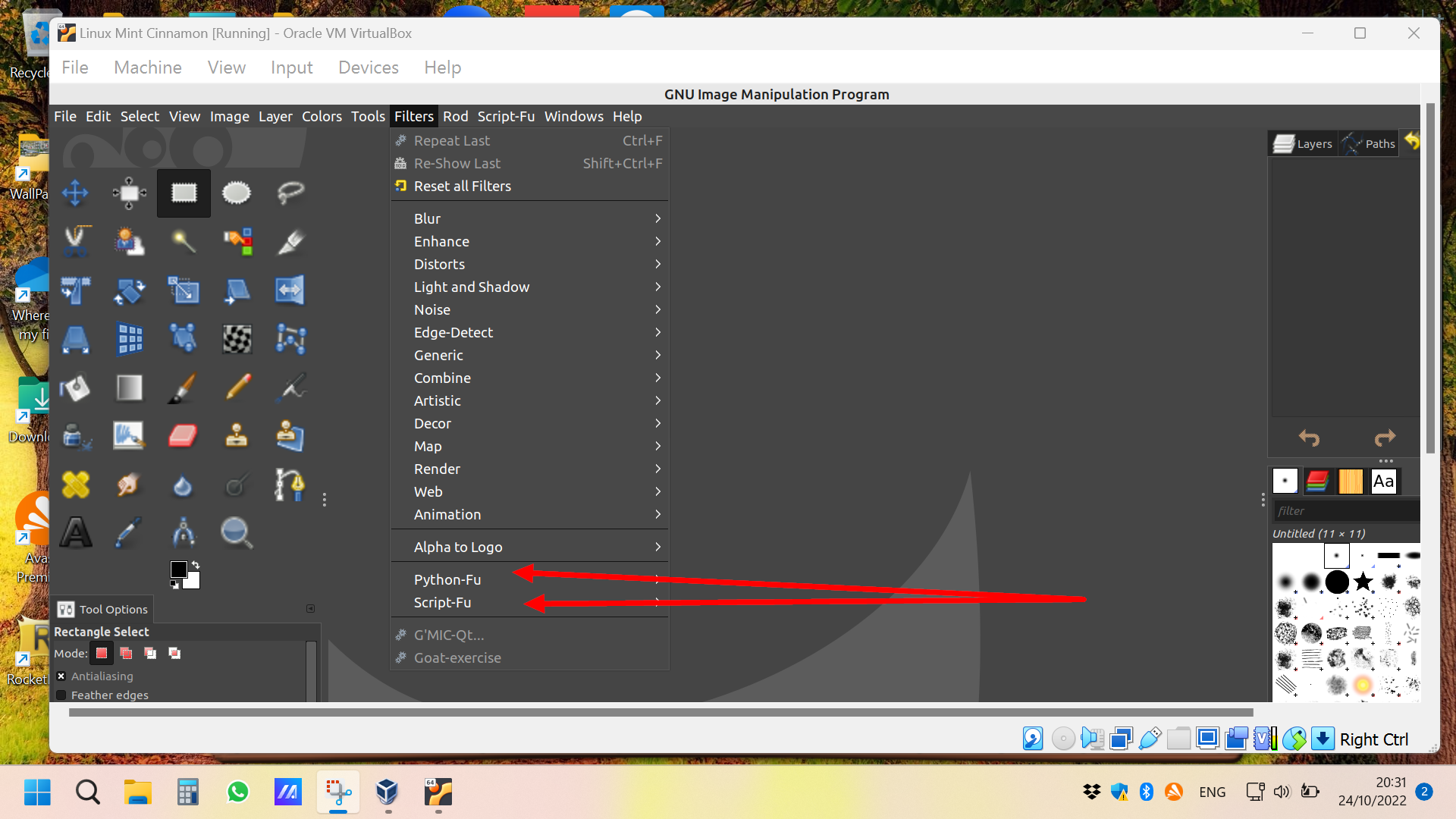

Hi Gimp users
I installed Gimp On Linux Mint inside a VirtalBox.

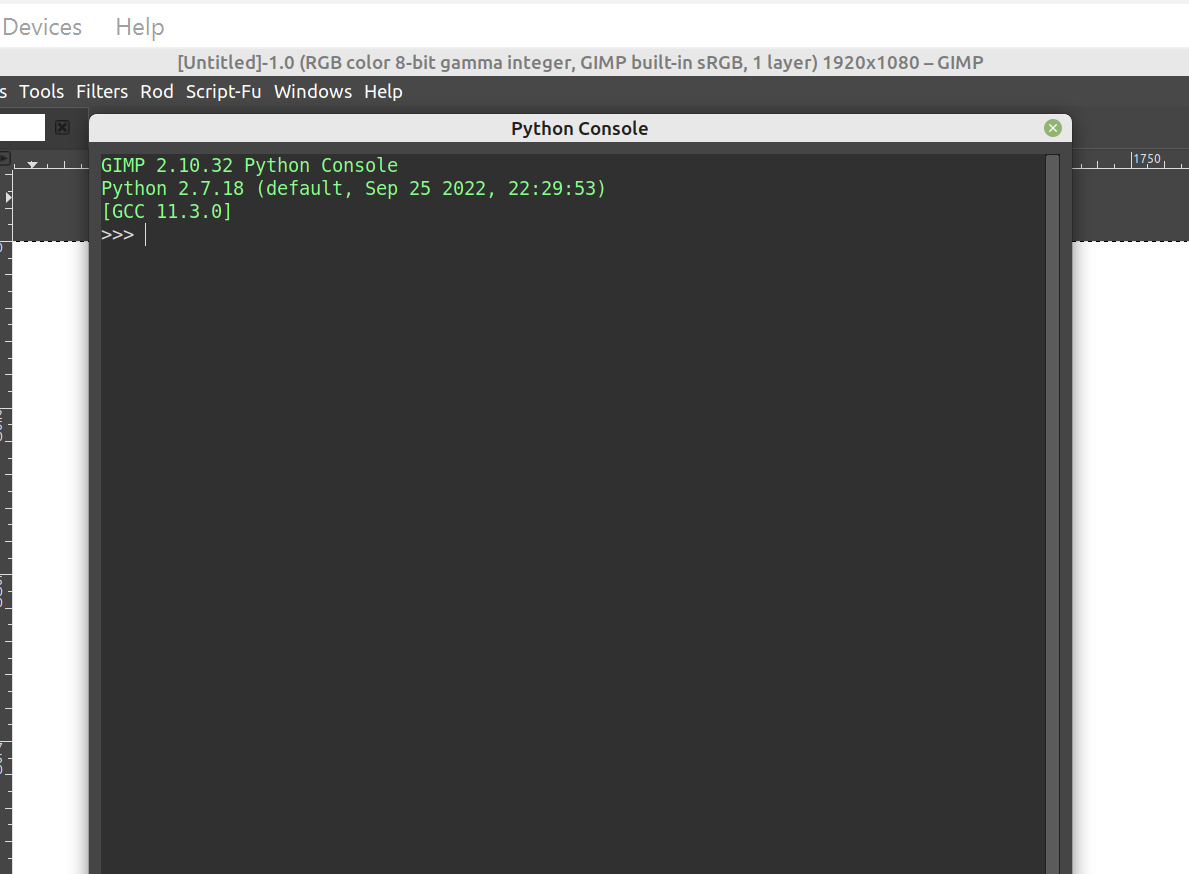

As you can see from the photo Gimp have :
Python-Fu and Script-Fu.
These are the commands and steps I made :
First I Install Flatpak with the terminal commands:
1) sudo apt install flatpak
2) flatpak remote-add --if-not-exists flathub https://flathub.org/repo/flathub.flatpakrepo
3) To complete setup, restart your system.
Then I installed gimp with the terminal commands:
1) sudo flatpak install flathub org.gimp.GIMP
2) flatpak run org.gimp.GIMP
Then I Get a Lists the available flatpak plugins for Gimp
with the terminal command:
1) flatpak search org.gimp.GIMP.plugin
For example I Add one of the plugin for GIMP
1) sudo flatpak install org.gimp.GIMP.Plugin.Resynthesizer
You can add few other plugins like : g’mic
I did not install the default gimp.
