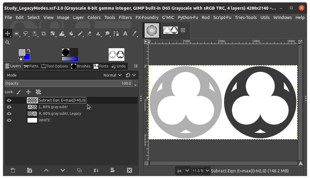

Here's a simple comparison in which an 80% gray layer is subtracted from a white layer in Default and Legacy modes.
(I've attached the project file too.)
Study_LegacyModeSubtract.xcf [235.19 KiB]
Downloaded 99 times

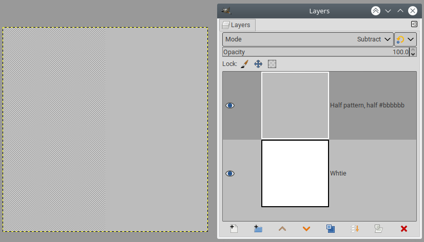

As I said above; "#bbbbbb" is not 80% gray, it is 50% gray. This the proof:
With the image above on your screen, step back (or like me, remove your glasses) until you can't make out the pixels in the left part. You'll notice that both sides look the same(*), so #bdbdbd is the color of something that is the same as half black and half white. In "linear light", this is .5, in other words, one half. So in linear subtract mode, If you subtract half gray (.5) from white (1.0) you get .5 again, and this .5 value is gamma corrected for the display so shows up as #bdbdbd".
Which is correct... because if you subtract half-gray from white, you should get half-gray. In the image above, if I add a layer of white under the image, and put the test layer in subtract mode, in the left part, the white pixels subtracted from the white give 0 (black) and the black pixels subtracted from the white leave the white. So the subtraction just inverted the pattern which is still 50% gray, and still the same as #bdbdbd.

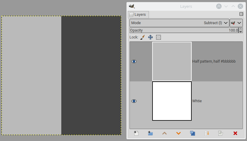

If you switch to Legacy mode, then Gimp works directly on Gamma values so you get 0xFF-0xBB=0x44:
Which is what you expect but is not coherent with what you have on the left.
So, legacy mode is the one where you can compute things easily, and the one you are used to, but it is not the one with correct results.
