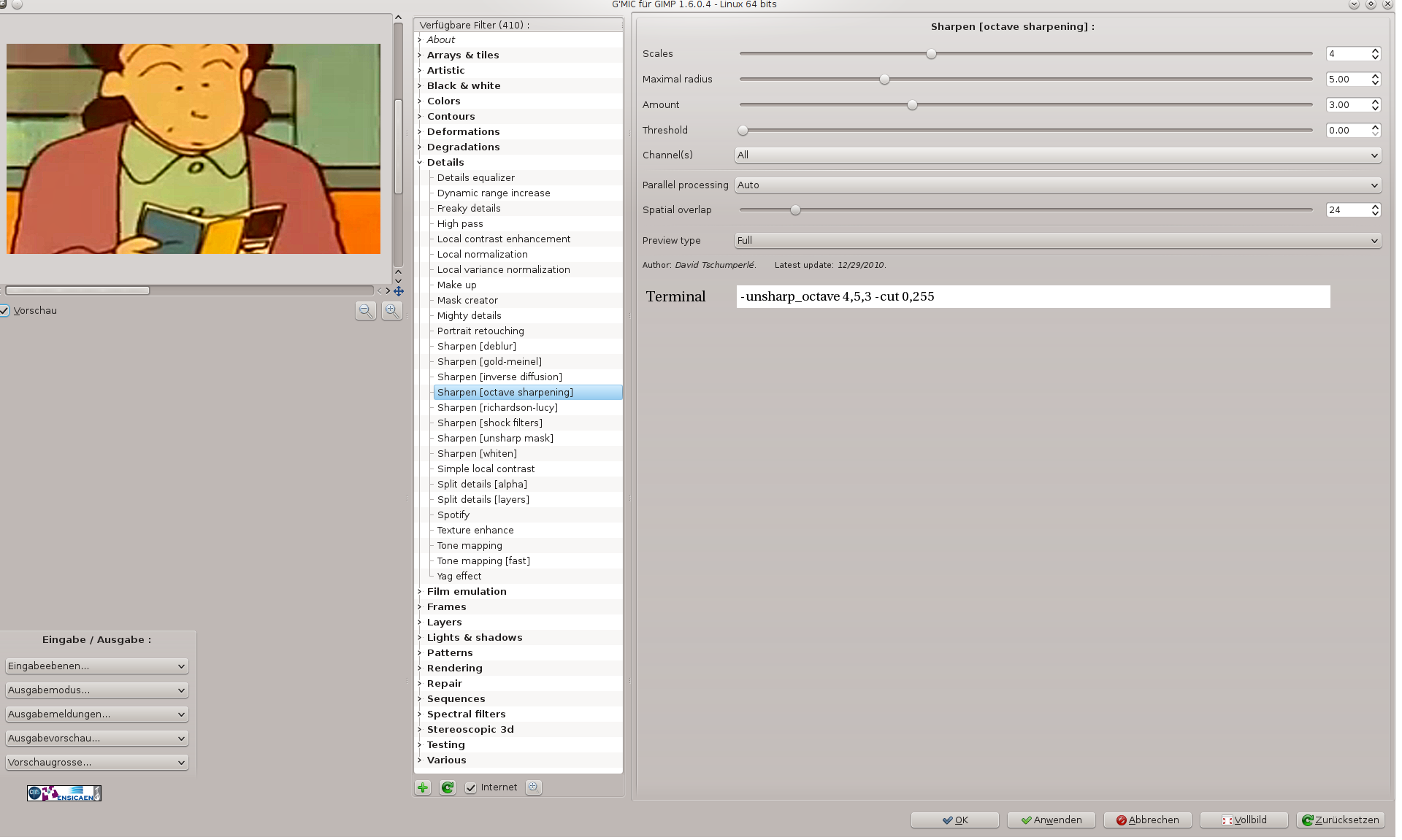

Hi
Could you add terminal command output field
for the filters
Terminal command:(-unsharp_octave 4,5,3 -cut 0,255)
./gmic test.png -unsharp_octave 4,5,3 -cut 0,255 test2.png
thx

Hi orti1980,
Not sure what you are asking. If you prefer entering an arbitrary set of G'MIC commands, free-form style, there is are Gimp-G'MIC filters just for that purpose. See Various -> Custom Code (local or global)
You may enter any number of G'MIC commands in a text box, preview the execution by pressing an update button, then commiting the commands to the active layer when you press OK.
In light of this, it would be somewhat redundant to replicate this on all four hundred or so filters.
Forgive me if I am misunderstanding what you are asking.
Garry

Why will only the output field show me the command as text

i edit an image with gimp and with a bash script same gmic command 50 images

Hi orti1980,
You can get the command line equivalent of any Gimp-G'MIC filter by starting Gimp in a shell, invoking the G'MIC plug-in and setting its output mode to "Verbose." The form of the command appropriate for a shell would then be echoed in the shell that you started Gimp whenever you use a filter. That is always current and never needs updating, as would an annotation printed on the filter itself. You can then copy this shell output into your own scripts.
Here is a tutorial on how to do this:
The command line behind the Gimp plug-in
Hope this helps.
Garry

Alternatively, if you set Gimp-GMIC's "Output mode" to "New layer(s)", the new layer is generated with a name containing the GMIC command that created it, eg:
[G'MIC] Corvo's painting 5 : -gimp_corvo_painting_5 35,10,10,0.5,50,0.3,50,2,5,1
