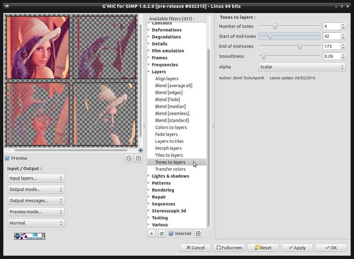

There is something in G'MIC which splits an image into several "luminosity" layers, maybe it can help ?

Ronounours,
I will look at "Tones to layers". Again, as my comment above, the darktable way of doing the masks seemed rather good - possibly because I am a retired electronic engineer and it corresponded to my ideas of bandwidth and "Q" factor!
david.

Ronounours,
I have had a quick look at "Tones to layers" - I will need to spend some time playing with it!
david.
