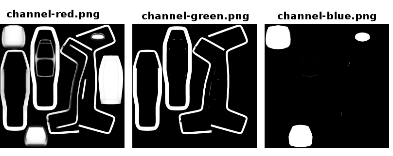

If you have your masks in three separate PNG files, such as:
Open the blue channel file and then use "File->Open as Layers" to open the green and red channel files. You should end up with a layer stack such as:
Change the image mode to grayscale ("Image->Mode->Grayscale") and then run the "Colors->Components->Compose..." command to open the following dialog:
After ensuring that the "Color mode" is RGB and that the red, green, and blue layers specified in the dropdowns correspond to their "Channel Representations" in the dialog, click OK and a new image will be created with your masks in separate channels (just like the example PNG file you posted).
