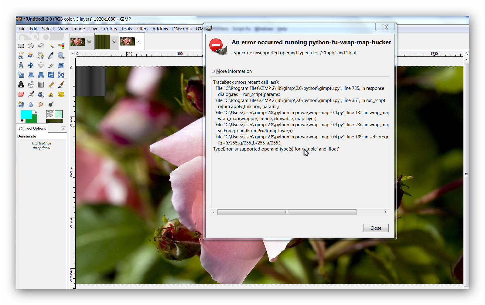

GIMP Version: 2.8.14
GIMP Experience: Basic Level
wrap-map (ofnuts)
see attached screenshot
just downloaded/installed the plug-in wrap-map (ofnuts)
I get the error show on ther screenshot when trying to follow the tutorial
GIMP Tutorial: Mitered & Grooved Picture Frames Using WrapMap
(note that I run version 0.4, while the tut talks about version 0.3)
any suggestion/recommendation?
thanks

What shows when you click on the "+" sign next to "More information"?
 Post subject: Re: Error while running Wrap-map (ofnuts)
PostPosted: Sun May 17, 2015 12:48 pm  (#3)
sorry for the delay (I was out for a while)
here the display when clicking on +

two questions:
1-could someone try to follow the same tutorial and check? (using latest version 0.4)
2-does someone have the previous version 0.3 which I could try?
Edit:
problem doesn't exist! My fault.
In spite of the fact that the selected map seemed to be correct, it was not!
Selecting the appropriate map the filter works!
I beg your pardon, Ofnuts, and all Gimp-chatters...

Glad you solved the problem, but that still means there is a bug, because it should have complained and not crashed. Can you post your image (or a small extract that still exhibits the problem) and tell me exactly what you were doing when encountering the problem?

It's not a problem of the image, it's due to the fact that in my procedure (it's an ongoing script I am writing) I do the following:
- open an image
- duplicate it
- create a square small selection
- duplicate the base layer
- from the selection create a palette using a filter (plug-in-smooth-palette) which create a new image (visible or not, user choice)
- then from that palette-image create a gradient
- overlay the selection with that gradient
at this point, during the development, I tried to perform the next steps interactively:
- select none
- create a new empty layer on the duplicated image
- select all
- select border 1 pixel
- run your script
because I tought that the default map selected was correct (the palette-layer was selected and visually it looks as the overlayed square layer of the duplicated image) I tried to run your script accepting the default!
once detected my error I modified the selection of the map (using the correct overlayed square layer of the image in process) adn the script worked fine.
Thus, if you want to investigate the missing check in your script, I guess you should control whether the wrong selection of an EXTERNAL layer-map (i.e. something NOT related to the image in process) could be checked and get a warning message.

It could work with a layer in another image (IIRC I designed it that way). What I don't understand is that the code retrieves the pixel color (which is a tuple or 1 to 4 elements, one for each channel, depending in the layer/image type), extracts/recreates the necessary R,G,B,A channels, and then divides them by 255. And the error is the division complaining that the dividend isn't a number but a tuple, and I can't image how the code could get a tuple there since that would mean that some elements of the color tuple are tuples themselves.
