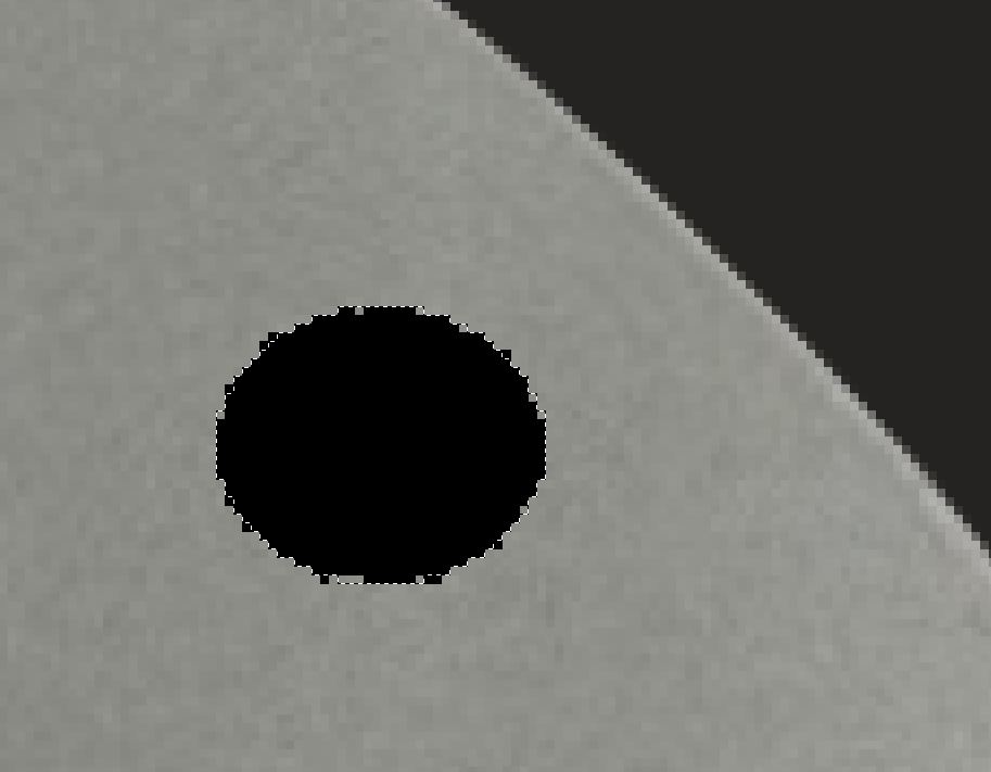

Hello guys and girls,
first I want to apologize for my English, but I am no native speaker...
I am pretty new to the GIMP world but so far I could solve all problems through searches in forums and youtube. But regarding my current problem I am completely stuck...
Out of nowhere suddenly the edges of a selection that I make are frayed. And if I want to fill that selection with a certain color, the filling goes over the edges of the selection and on other parts doesnt reach the edges of the selection.
I attached an image to show you what I am talking about. On the right side there is an object that I created through the use of a selection and the filling of that selection. Everything is good there. But on the left side you see what my problem is. What I really dont understand is how that happened...
What i tried so far is restoring the default settings for all the tools. That didnt work... Then I reinstalled the entire programm, but with no sucess either...
BTW: I tried it on different pictures, on old GIMP projects and on completely new pictures. It is always the same...
I have no idea what to do now... I hope you guys can help me!!
Thank you in advance.
Greetz Dominic

You tried select the affected area with "Fill whole selection"? Or tried on white background? This may be the effect of "Fill similar colors" with threshold 15 (default) as your background is not of the same color.

This seems to have something to do with a previous selection that was made and filled. If you're trying to create an elliptical selection, why not use the ellipse selection tool? :elipse

In the Ellipse Select Tool options, make sure antialiasing is checked.
Thanks for all your answers!!!
But I filled it with the setting "Fill whole selection"... So that seems not to be the problem.
For the selection in my attached image I used the elliptical selection tool...
That setting is also checked in the ellipse selection tool.
I am pretty sure that there is a problem in my system... I just did a reinstall again, this time with renaming the old profile so that a new one is created... No success. Is it possible that my (dot)NET framework got corrupted? It is just an idea cause it told somewhere in the installation info that (dot)NET is required...

Hey, it seems that the problem is solved... kind of...
It seems that the problem occurred cause I had the bucket mode setting "dissolve" activated (I am not sure if this is the correct translation, it is the second mode right under "normal").
I am writing that the probem is solved "kind of" because I am absolutely sure, that I used that exact setting for the editing in this picture and also for other pictures before...
So I still dont get it, why this turned up out of a sudden...
I want to apologize for the hassle cause apparently my problem was kind of "self made"!
