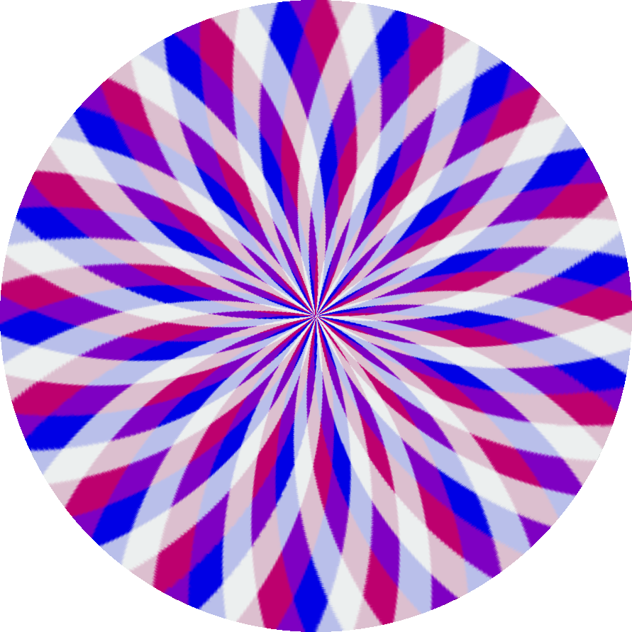

As a side note, before saving your PNG file, make sure you see an image that looks like the following (with the grid pattern in the background indicating your image indeed has transparent pixels). :)

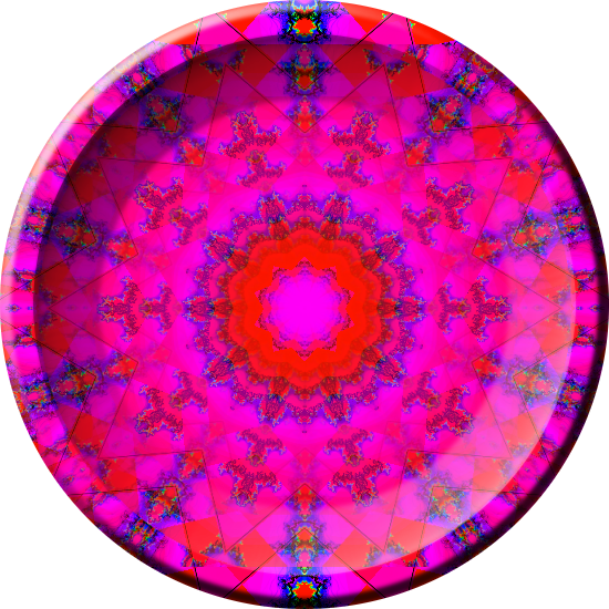

You didn't mention if you've tried the image in the game that the image was made for.
Also, if you exported the image as a PNG with a transparent alpha channel, as seen in Lyle's example image showing a transparent alpha channel, then open your image to review it using Windows Photo Viewer. It will appear as though it doesn't have an alpha channel or with a white background.
You also haven't explained how it is that you know that the alpha channel of your image doesn't retain it's transparency.
Can you post the xcf, or the PNG image as it was exported using Gimp, so we can examine it to see if indeed that it does or doesn't contain a transparent alpha channel.
Can you tell us if the image below contains a transparent alpha channel?
