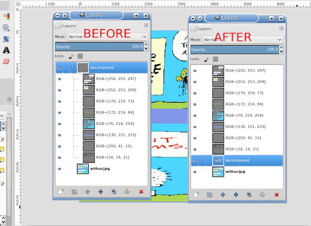

I have two other scripts, Group Linked Layers and Ungroup Layer, which can be used in combination to assist in doing that.
First set the "chainlink" for the layers you wish to move out of the group and then run "Layer->Stack->Group Linked Layers" (the command is also available by right-clicking on one of the layers in the Layers dialog). Next, drag the newly created group layer out of the layer group. Finally, run "Layer->Stack->Ungroup Layer" (also available from the right-click menu) on the moved group layer if you want those layers not to be grouped together.
Note: if you want to remove all of the layers from the group, just run "Ungroup Layer" on the group layer.

Also this one http://registry.gimp.org/node/28596
ungroup_grouplayer.py
looks like this
